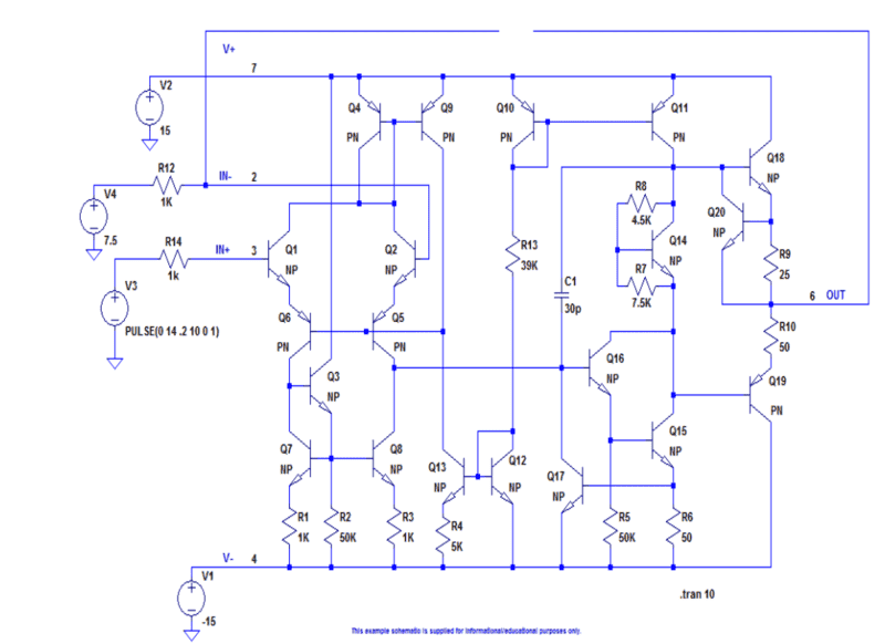

(Not actually a homework) There are about 20 BJT's used in the internal circuit of a 741 op-amp, along with resistors and capacitors. I want to understand how this circuit works, and what role each BJT has to play. Sometimes, more than 1 BJT have to play a common role together.
Concepts to be used -
a) Differential Amplifiers
b) Wilson Current Mirror
c) Widlar Current Mirror
d) Emitter Follower
e) Darlington Pair
f) Voltage Amplifier (A or B class, probably)
Here is the internal circuit of a 741 op-amp -
Here is a HSpice model I found in the educational section -
Both are essentially the same, keeping aside subtle differences. I am yet to understand the technicalities of an op-amp, so I would like to analyze the circuit using the first picture. The colored blocks represent the following, according to me-
a) Dark Blue - The input stage, a cascaded differential amplifier using emitter followers and common-base biased BJT's.
b) Purple - Voltage amplifier stage
c) Red - Current mirrors
d) Green - Current amplification with low output impedance, along with a possibly short-circuit protection.
e) Cyan - The output stage, with low output impedance, high current gain
The inputs are at Q1 and Q2, which serve as emitter followers. They are supposed to provide high input impedance for a high open loop voltage gain. Q8 and Q9 serve as the current mirror, where Q8 serves as the reference for Q9. Q3 and Q4 are matched with Q1 and Q2 respectively to ensure better ##V_{BE}## for protection, and also to increase frequency response. It seems that a feedback is sent to the bases of Q3 and Q4 from Q9's collector. Also, the collectors of Q1 and Q2 are connected to the emitter and base of Q8, respectively. What does this signify? I can't really seem to understand? I would like to take this step by step, so I would like someone to confirm at first if my hypothesis regarding the workings of Q1,Q2,Q3,Q4 are correct or not, or do they perform some additional roles as well? After that, I can move on with the next parts, otherwise if I make a mistake in the beginning, it would be difficult to analyze later on, especially with 20 BJT's around!
Respectively? I don't think so. Note that Q8 has B and C tied together, and supplies current to the Collectors of both Q1 and Q2.
If Q1, Q2 draw more current, Q9, being part of a current mirror, will pass more current cutting off Q3, Q4.
You thus have a negative feedback loop around the input stage, stabilizing the Q4 collector voltage; and maintaining an approptiate bias to Q15 - the output section.
Q16, Green, is biasing to set the output stage (Q14, Q20) quiescent current, eliminating crossover distortion, probably class AB. (Enter the circuit in a simulator such as the free LTSpice to see all the bias points.)
The Output current limiting is done by Q17 and the 25Ω resistor. At roughly 28mA load current, Q17 turns On and diverts Q14s base drive. This eliminates any smoke signals when Q14 overheats from a shorted output.

Yeah, I had made a mistake in noticing Q8's common-base configuration.
Also, I would like to move on to the green block once I'm done with the previous blocks. Thanks for the explanations.
One thing I would like to ask - Is the differential amplifier's purpose fulfilled by Q1,Q2,Q3 and Q4 only, or does the entire dark blue block functions as a differential amplifier as a whole? Like, what exactly happens in the input stage if we put in differential inputs at the terminals of Q1,Q2 ?
Also, the next part in the dark blue block seems to be a Wilson current mirror with an active load driven by Q7. So, does Q3 act as a current source in this case, as there is no resistor, which is present in a typical Wilson current mirror? So, is the input circuit functioned to act as a current source?

Q8-Q9 are connected the same as Q12-Q13 and Q8 is the reference for the current source Q9. See:
https://wiki.analog.com/university/courses/electronics/text/chapter-11
Q5,6,7 are a Buffered Current Mirror, see sect. 11.7 in the link above.
And yes, I would consider Q3 to be the current source for Q5,6,7.
You can probably figure out the answers to many of your questions, and learn a lot more, if you get a free copy of the LTSpice simulator from:
https://www.analog.com/en/design-center/design-tools-and-calculators/ltspice-simulator.html
It is pretty easy to use once you get started. You can enter your opamp schematic using the generic NPN and PNP transistors that are part of the download library. It's great for probing voltages and currents at various points by connecting a virtual meter to the point of interest. Many of us on this site use it for quick circuit design and evaluation.
And here is a download that seems to describe the separate operational stages of the 741. I've only glanced at it, so no guarantees!
https://cdn.evilmadscientist.com/KitInstrux/741/741_principles_RevA104.pdf
