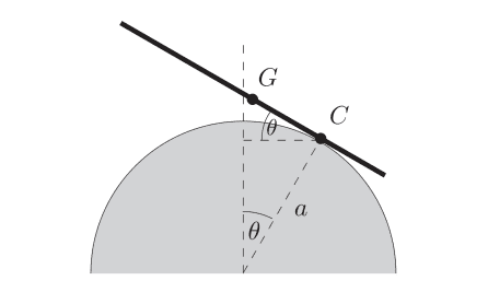

C is the point of contact and G is the CM of the plank . x be the distance between G and C .Since plank always remain in contact , x=aθ
When the line joining the point of contact C with the center makes an angle θ with the vertical ,the force due to gravity mg acts vertically down and exerts a torque about the point of contact C.
Torque due to Mg = Mgxcosθ
Since θ is small , cosθ ≈ 1 and using x=aθ
Mgxcosθ ≈ Mgaθ
Moment of inertia about C = M(2b)2/12 + Mx2 =Mb2/3+Ma2θ2
Since θ is small , θ2≈0
Moment of inertia about C = Mb2/3
Writing torque equation about C ,
-Mgaθ = (Mb2/3)α ( α is angular acceleration )
α = -3gaθ/b2
Angular frequency of oscillation ω = √(3ga)(1/b)
Time period = 2π/ω = 2πb/√(3ga)
Is my work correct ?

Jahnavi said:
correct ?
Looks good.
Thanks !
