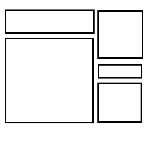

I'm using linear layout to make two so that I can insert up to 6 images. For example, if I have one image it will fit in the center of that layout if I have two it will divide the space equally for the two images, etc.
So far I have this,

I used two vertical linear layouts to make the rows. How do I tell the images to fit the box if there's one, to split equally if there's two, etc.?
I'm placing the linear layout (rows) in the biggest box (first column second box).
Since I'm late I'll just give you the answer.
This is better done with a ListView, but following the way you want to do it, I would just add weight to each image during run-time. All images are added programatically in a linear vertical layout so they will occupy space in a vertical manner. Since they are fixed we use 6 variables, but you can use a list or an array. Before I give you the code, here is a screenshot of the resulting code. If this is not what you want, then there is no need to read any further. Still, I think you can use it and customize it to your needs.
Inside the first column second box layout you will add:
