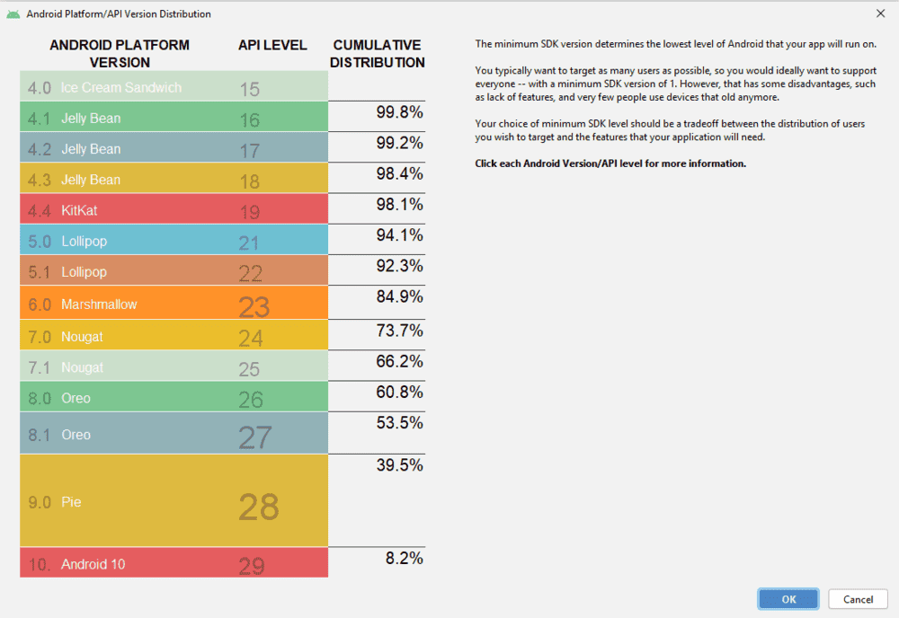

jedishrfu said:
Rather than pursue this error in the OS for 19 perhaps you can find stats on the number of people using that version and then decide if it’s worth pursuing.
When creating a new project in Android Studio, it gives a cumulative distribution chart for the version distribution:
Table titled Android Platform/API Version Distribution listing Android versions from 4.0 Ice Cream Sandwich (API 15) to 10 (API 29) with cumulative distribution percentages, from 99.8% for 4.1 down to 8.2% for Android 10.
From the above, about 4% of the Android phones are Kitkat. If this problem continues, I will have to ditch support for Kitkat and go straight up to Lollipop 5.1. I cannot publish an app to Play Store with a known bug.
