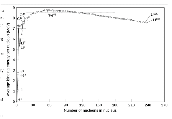

No need to repost. You will get good replies here in this technical forum.
Have you read anything about Binding Energy and nuclear fusion?
https://en.wikipedia.org/wiki/Nuclear_binding_energy

No, heavy metals do not lower/reduce the temperature at which fusion can start/occur. The higher the Z, the higher the temperature to fuse, due to coulomb repulsion. Heavy metal nuclei also recombine with electrons which produces relatively low energy photons that radiate from the plasma. At some point, like around Ni (Z = 28), fusion doesn't occur.
Heavy metals are the 'ash' of the fusion process, not the fuel. It's complicated, but heavy metals do not lower the temperature at which fusion occurs.
