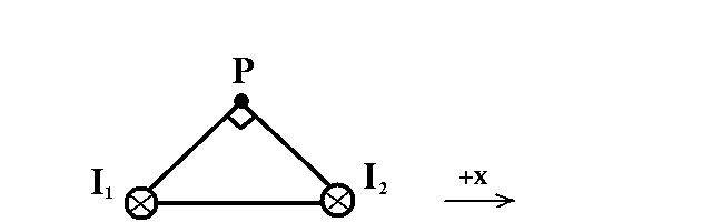

Two long horizontal straight parallel wires are 3.18 cm apart and each carries a current of 9.25 A in the directions shown in the above figure. What is the magnitude of the B-field at point P, which is at a perpendicular distance of 2.25 cm from both wires?
What is the direction of the B-field at point P? Give the angle between the x-axis and the B-field in degrees (give your answer as an angle between 0 and 359 deg.).
I did part 1, and found the magnitude of the B-field, which is 1.16×10-4 T and is correct, and then I'm stuck on part B, I think according to my image, the x and y components both will double, but it shouldn't affect my angle, but it's wrong. I think my assumption is wrong. Can anyone please help me with the angle?

the y components will cancel out, and the x components will add up. check it by thinking about the tangent to the magnetic field line at P due to each wire.

If my y components cancel out and my x-components add up, then will my angle be 359?

My y components canceled out and the total magnetic field is just 2*the x component of one wire.
Doesn't this mean it has to be in x direction if there's no y component..
It should be 180, but that's wrong and so is 0.
Actually, it's the x components that cancel out, not y, so the angle should be 270?

Is your question exactly the same or only similar? Current directions matter.
It's slightly different. Currents are in opposite directions. 270 doesn't seem to be correct either though.
Well there you go; you'll need to see how that affects the B-field directions.
