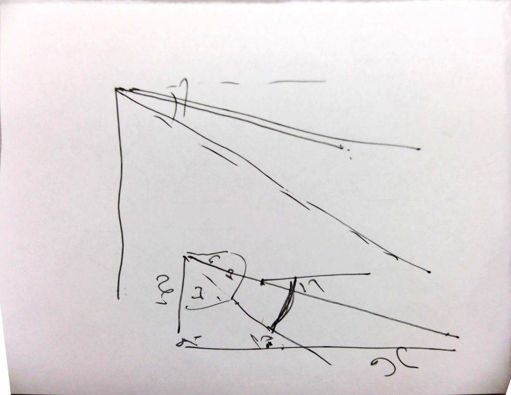

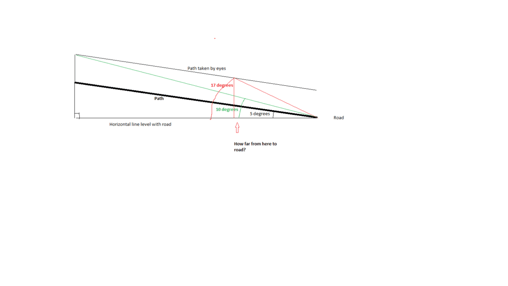

James' eye are 150cm above the ground. When he was standing on the path, the edge of the road was at an angle of depression of 10 degrees. After walking down the 5 degree slope of the path, 10m towards the water, the angle of depression increased to 17 degrees. How much further would he need to walk to reach the road.

Is it like using the sine rule to figure it out:
1.5/sin 68 = x/sin 17 = 0.47 which doesn't seem to be correct. I tried to determine the angle. I though the 5 degree slope means it could be 95 degrees cause the triangle looks like a right angle triangle.
Is there a diagram with this? I am unable to figure out the picture from the words. It starts off with just a path and a road (is there a kerb?), then there is mention of water.
I would guess he's walking down a 5 degree slope towards a road. Water might be further down the slope but is irrelevant since the angles of depression are wrt road.

bnd_20191 said:
1.5/sin 68
It would be good to provide an explanation on how you arrived at the 68. It appears that you have taken the angle of depression (17 degrees after the downhill stroll) and added it to the slope of the path (given as 5 degrees), subtracted from 90 degrees and taken the sine.
Per Google, the angle of depression is conventionally referenced against the horizontal, not against the local surface.
A drawing to show your thought processes would help enormously.

Try this drawing instead. [Clearly I am not an artist]
