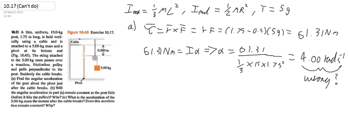

Handwritten working for a rotational dynamics problem: I = (1/3)ML^2, I_rod = (1/3)mR^2 (as written), T = 5g; part a) torque = r x F = rF = (1.75 - 0.5)(5g) = 61.31 Nm; then 61.31 Nm = I alpha, alpha = 61.31 / ((1/3)(15)(1.75)^2) = 4.00 rad/s^2, circled and marked 'wrong?'.
The method I'm using in the image is the one that makes the most sense to me, but I've tried others and still cannot get at the stated answer, which is 2.65 rad/s^2
Do not assume that the tension in the rope equals the weight of the hanging mass. Set up two equations, one for the post and one for the hanging mass. Then you can solve for the acceleration.

Sorry, how do I go about that? If the tension in the string isn't 5g, I don't know how to do it.

Don't guess, solve! Call the tension T and set up your equations. That will be one of the unknowns. Luckily, you'll have two equations and two unknowns.

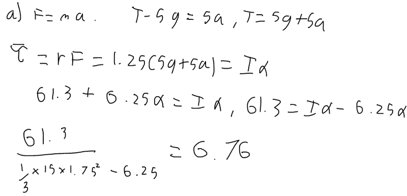

Well, regardless, I still get the wrong answer:
Handwritten derivation: F = ma, T - 5g = 5a, T = 5g + 5a; torque τ = rF = 1.25(5g + 5a) = Iα; 61.3 + 6.25α = Iα; 61.3 = Iα - 6.25α; then 61.3 / (1/3 × 15 × 1.75² - 6.25) = 6.76.
And I checked, in case I mixed my signs up, adding 6.25 rather than subtracting, which gives 2.84, still not the correct answer.

You need to fix the sign of "a" in your equation for the hanging mass.
And how does alpha relate to "a"?

Write your equations. Tell me how alpha relates to "a".
Don't solve them, just write them.
(I solved it and got the correct answer, so we need to see where you are going wrong.)

I don't know how it relates it general, but at that instant, they are the same?
5g - T = 5a
[itex]\tau = rF=r(5g-5a) = 61.3 - 6.25a = Ia, a(I+6.25) = 61.3[/itex]
[itex]\frac{61.3}{\frac{1}{3}*15*1.75^2 + 6.25} = a[/itex]
a = 2.84

How can an angular acceleration (in rad/s^2) be the same as a linear acceleration (in m/s^2)?
But they are related. Consider the point of attachment of the rope with the post. How does the linear acceleration of that point relate to the angular acceleration of the post?

Ok, [itex]a=r\alpha[/itex]
Solving from there is just basic algebra. Prior to googling, I had not seen this, nor thought about a concrete relationship between them, which must've been why I could not see how to do the problem. Thank you for putting up with me :P

Now you've got it. :approve: You should be able to the the correct answer now.
