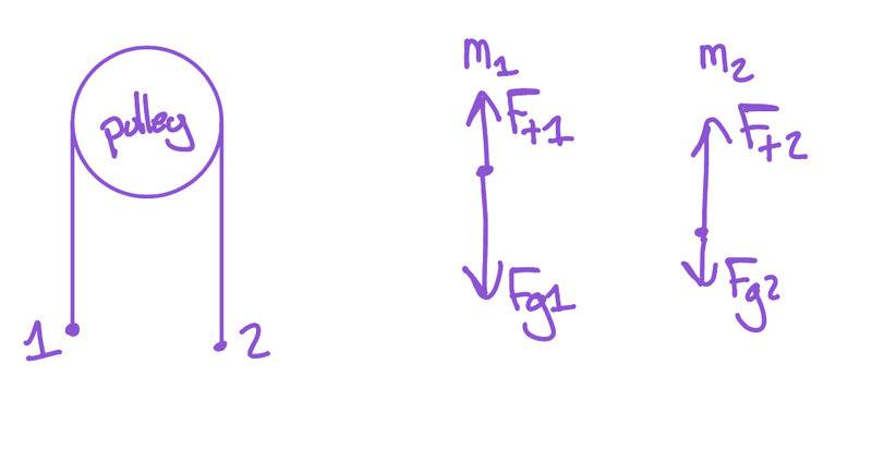

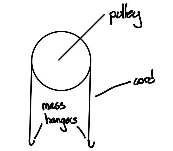

Use the equipment shown in the diagram to design an experiment to determine the acceleration due to gravity. Use a total mass of 0.5 kg to 1 kg on the mass hangers. Standard lab equipment may also be used.
(Diagram Below)
##F = ma##
^ This is my personal drawing of the diagram, I couldn't take a picture of the actual one. The setup is a pulley wrapped with a cord and mass hangers attached to each end.

However checking the answer key I found I was completely wrong. They first placed equal masses on each hanger, then removed some mass from one side to the other side. This created an inbalance in the net force, and since it was originally at rest with the balanced masses, transferring the mass essentially allowed them to know the net force acting upon the system. Which was the difference in weights of each hanging mass. From there they let the masses fall and recorded the acceleration of each mass. Each trial they increased the difference in masses. They then made a graph of ##\frac{m_1-m_2}{m_1+m_2}## on the x axis and on the y axis was the acceleration of the masses. The slope of this graph was the experimental value of gravity.
I'm still confused as to how they got their answer, but I did recognize some variables. If a graph of ##\frac{m_1-m_2}{m_1+m_2}## on x and ##a## on y gives a slope of g. Then ##g = \frac{a}{\frac{m_1-m_2}{m_1+m_2}}## which is ##g = \frac{a(m_1+m_2)}{m_1-m_2}## From this, I think that they got their equation from ##F = ma## since:
Is the same as:
##(m_1-m_2)g = (m_1+m_2)a##
Which is pretty similar to F = ma, since the net force is indeed equal to ##(m_1-m_2)g## (I think)
However, couldn't you not use this since the pulley would need to be accounted for? I am assuming the pulley has non-negligible mass, since this is an experimental design.
My questions are:
Would my original strategy have worked?
How did they get their answer on the answer key?
You are right that the inertia of the pulley must be taken into account. Their equation should be ##g = \frac{a(m_1+m_2+I/r^2)}{m_1-m_2}##.
Your method is ok in principle but rather indirect. And this is not right:
##\Delta L = \tau_1r##
You mean ##\Delta L = \tau_1t##, which means you have to measure t as well as a.
If you are going to measure t, use the drop distance to calculate a and apply the corrected acceleration formula above..

Very sorry for the 7 day late response, I was unable to respond temporarily. To prove your equation above, I tried to derive the tensions and then solve for g, but then I was unable get pass a road block. Here are my derivation:
My FBD's:
Assuming ##m_1## > ##m_2##
For the force of tension acting on Mass #1:
##F_{g1} - F_{t1} = m_1a##
##F_{t1} = m_1g - m_1a##
##F_{t1} = m_1(g-a)##
For the force of tension acting on Mass #2:
##F_{t2} - F_g = m_2a##
##F_{t2} = m_2(g+a)##
Then putting it into the torque of the pulley:
##\tau_{net} = I\alpha##
##\tau_{net} = F_{t1}r - F_{t2}r##
Substitution from above
##\tau_{net} = m_1r(g-a) - m_2r(g+a)##
##I\alpha= m_1r(g-a) - m_2r(g+a)##
Distribution
##I\alpha = m_1rg - m_1ra - m_2rg - m_2ra##
##I\alpha = g(m_1r - m_2r) - a(m_1r + m_2r)##
Adding and division to get:
##g = \frac{(I\alpha + a(m_1r + m_2r))}{(m_1r - m_2r)}##
And since ##\alpha = \frac{a}{r}##
##g = \frac{I\frac{a}{r} + a(m_1r + m_2r)}{m_1r - m_2r}##
Dividing r out
##g = \frac{I}{r^2}a + \frac{a(m_1 + m_2)}{m_1 - m_2}##
And then factoring out an ##a##
##a(\frac{I}{r^2} + \frac{(m_1 + m_2)}{m_1r - m_2}) = g##
I was able to get a really similar equations to yours in Post #2, but I'm unsure how to merge the fractions together. How did you get your equation from here?

##\frac {m_1 + m_2 + \frac {I} {r^2}} {m_1 + m_2 + \frac M 2} = 101/100## (The 101/100 since 1% error)
Cross multiplication
##101(m_1 + m_2 + \frac {M} {2}) = 100(m_1 + m_2 + \frac I {r^2})##
Distributing and Subtracting
##m_1 + m_2 + 101 \frac M 2 = 100 \frac I {r^2}##
From here, I'm still uncertain as to how to get rid of I within the equation. I know that ##\frac I {r^2}## is some fraction of mass ##M##, but since that fraction is not known we can't get rid of I?
uSee2 said:
##\frac {m_1 + m_2 + \frac {I} {r^2}} {m_1 + m_2 + \frac M 2} = 101/100## (The 101/100 since 1%)
I did not mean those two expressions. I wrote, the one considering I (either ## {m_1 + m_2 + \frac {I} {r^2}}## or the uniform disc version ##{m_1 + m_2 + \frac M 2}##) and the one ignoring I, just ##m_1 + m_2##.
Oh I see now, thank you! So:
##\frac {m_1 + m_2 + \frac M 2} {m_1 + m_2} < \frac {101} {100}##
##100(m_1+m_2+\frac M 2) < 101(m_1 + m_2)##
##100m_1 + 100m_2 + 50M < 101m_1 + 101m_2##
##50M < m_1 + m_2##
##M < \frac {m_1 + m_2} {50}##
And then if ##\frac I {r^2}## was used instead
##100(m_1+m_2+\frac I {r^2}) < 101(m_1 + m_2)##
##100m_1 + 100m_2 + 100\frac I {r^2} < 101m_1 + 101m_2##
##100\frac I {r^2}< m_1 + m_2##
##\frac I {r^2} < \frac {m_1 + m_2} {100}##
All of this to get less than 1% of error right?
##50M < m_1 + m_2##
Yes.
