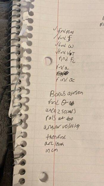

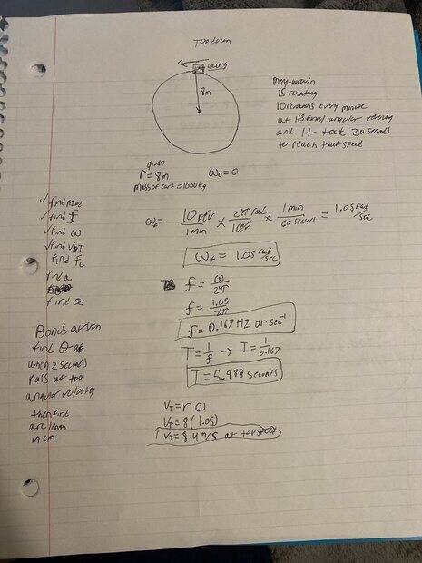

Hopefully I did everything up to the theta part correctly but I do not understand how I’m getting 2 different answers using 2 different equations. It’s worth noting that I designed this problem myself. Also what would be the units for theta in this case and the units for s in s= r *theta
Omega final ^2= omega initial^2 +2 alpha theta
Theta = omega initial * time + .5 alpha*time^2

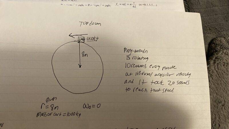

Handwritten sketch of a circular merry-go-round viewed from above with a cart on its rim, a radius arrow labeled 8m, a leftward arrow marked to-down, and notes: given r = 8m, mass of cart = 1000 kg, omega_0 = 0.
Handwritten notes on lined notebook paper listing steps: find frequency, find f, find omega, find v of T, find Fc, find alpha, find theta; below, Bonus answer, find theta when 2 seconds pass at top angular velocity, then find arc length in cm.
Handwritten physics solution on lined paper: centripetal force Fc = mv^2/r = m(omega^2)r, Fc = 1000 x 8 x 1.05^2 = 8820 N; angular acceleration from omega_f = omega_0 + alpha t giving alpha = 0.0525 rad/s^2; tangential acceleration a = r alpha = 0.42 m/s^2; angular displacement and arc length s = r theta = 8(10.5) = 84 m.
Handwritten physics work on lined paper: a top-down sketch of a merry-go-round of radius 8 m with a rider, a worked angular kinematics calculation converting 10 rev/min to 1.05 rad/s, and frequency and period computed from it.
Also if you can’t read my handwriting it says a merry-go-round is rotating 10 revolutions every minute at its final angular velocity and it took 20 seconds to reach that speed

A bit painful to follow you needlessly approximate a ##\pi## early on and end up with calculating a rev every 5.988s.

The actual question is Find frequency find angular velocity find the tangent velocity find centripetal force find linear acceleration find angular acceleration and the part where I got lost is to find Theta, which I don’t really know what it is or how it’s different from s. My question about this question is why I’m getting 2 different answers for theta.
Your scribbling for "bonus" seems to indicate that ##\theta## is supposed to be the angular displacement during 2 seconds at final velocity, so both answers are wrong.
I think your first step should be deciding, not the value of ##\theta##, but what ##\theta## is supposed to represent. Since you wrote the question yourself, that shouldn't be too difficult.

In one of your methods you used t=2s instead of t=20s.

hmmm27 said:
Your scribbling for "bonus" seems to indicate that θ is supposed to be the angular displacement during 2 seconds at final velocity,
As I read it, the right hand scribble gives the displacement from rest over 2 seconds at the calculated acceleration. The left hand gives it over 20 seconds, hence their ratio of 100:1.
