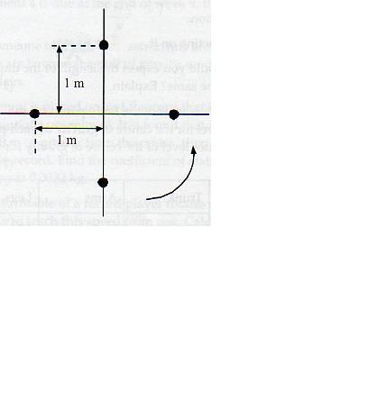

The system of point masses m shown in the above figure is rotating at an angular velocity of 2rev/s. The masses are equal and connected by light flexible spokes that can be lengthened or shortened. What is the new angular velocity if the spokes are shortened from 1m to 0.5m?
Not sure how to approach this question. Someone please guide me.

I presume this is meant to be a conservation problem. What's conserved, assuming no external forces act?
how do you know that? When do you know that you are dealing with a conservation problem??
That's just my guess (otherwise I don't see the point of the question). I'd say that the problem is very poorly worded.
From reading my text, I say that angular momentum is conserved.
Using the equation: I1 * omega1 = I2 * omega 2
To solve the equation, we have to solve for omega 2. Is that right?

Exactly.

Here is my calculation:
therefore omega 2 = I1 * omega 1/ I2
= mr^2 *omega 1/ mr^2
= r^2 * omega 1/ r^2
= 1^2 * 2rev/s/ 0.5^2
= 8 rev/s
so when the spokes are shortened, the velocity increases. am i correct??

Perfectly correct.
