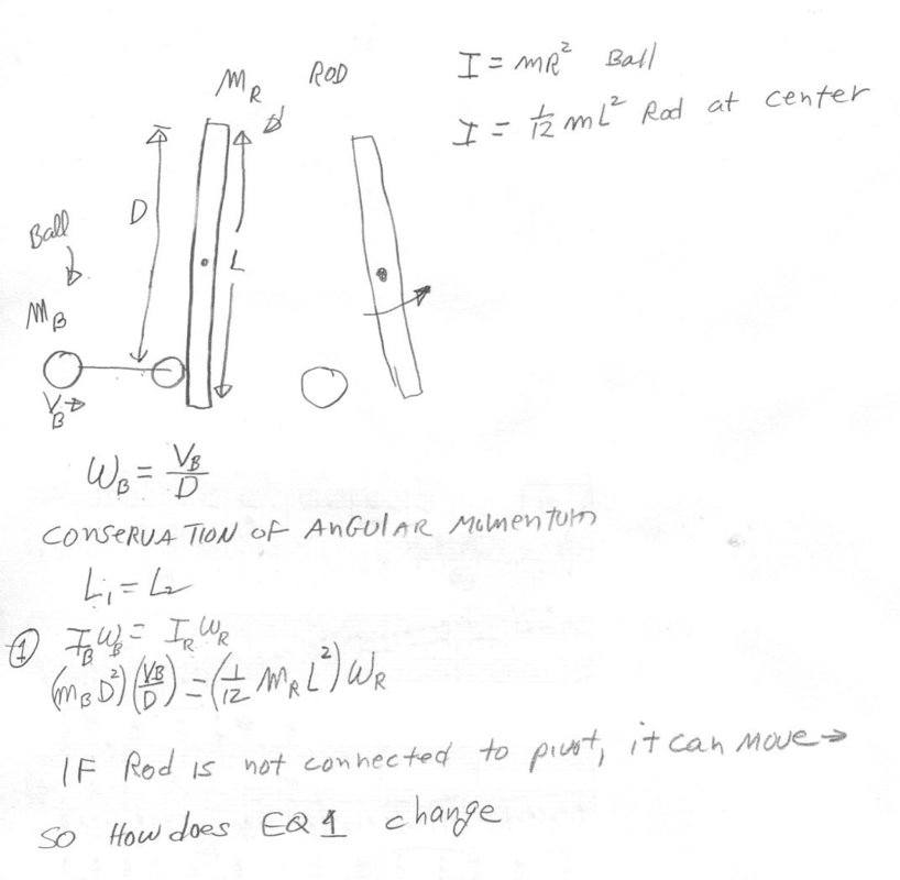

Ball of mass mb and velocity vb hits rod of length L , Rod pivots about the center. What is the angular momentum aafter impact?
I = 1/12 (mR^2)
I = mR^2
Homework Statement:: Ball of mass mb and velocity vb hits rod of length L , Rod pivots about the center. What is the angular momentum aafter impact?
Homework Equations:: I = 1/12 (mR^2)
I = mR^2
See the attached figure. I understand the concept of linear and angular momentum separately but I am confused as to how to use both at the same time. In the attached diagram ball B hits a rod that pivots in the center. In this case we have a classic case of conservation of angular momentum. However, if the rod is free to move, i.e. not connected at the center to the pivot, then the rod would move horizontally as well as rotating. I am having trouble finding an explanation as to how to add the linear momentum to the equation. Are they handled separately or can I have one equation for the angular part and another for the linear part?
I know that initially I would have a linear momentum of the ball being Mb X Vb. Would this be equal to the Mr X Vr where Vr is the linear velocity of the center of mass?

Both linear and angular momentum are conserved. Equations are equations and if they include common variables they can be combined in any way that is mathematically valid.
PS remember that angular momentum is defined relative to a given point. So, you are also free to choose the point about which you measure angular momentum of the system.

I don't understand your equation (1). Can you explain that? Why are those two quantities equal?
@PeroK has answered your main question, but in solving the actual problem you seem to have forgotten about what happens to the ball afterwards. More information is needed, e.g. it sticks to the rod, or bounces elastically, or happens to come to rest, etc.
Referring to my attached sketch, if the ball strikes the free rod at the center of mass, then there would be no rotation only a linear translation then I could say that mb X vb = mr X vr. Would this be a good equation if the ball stikes the rod off center?
I just realized that the initial angular momentum is incorrect because the center of toation was taken from the end of the rod not the center.
Oh, I forgot. this is an elastic collision and the ball remains stationary after the collision.

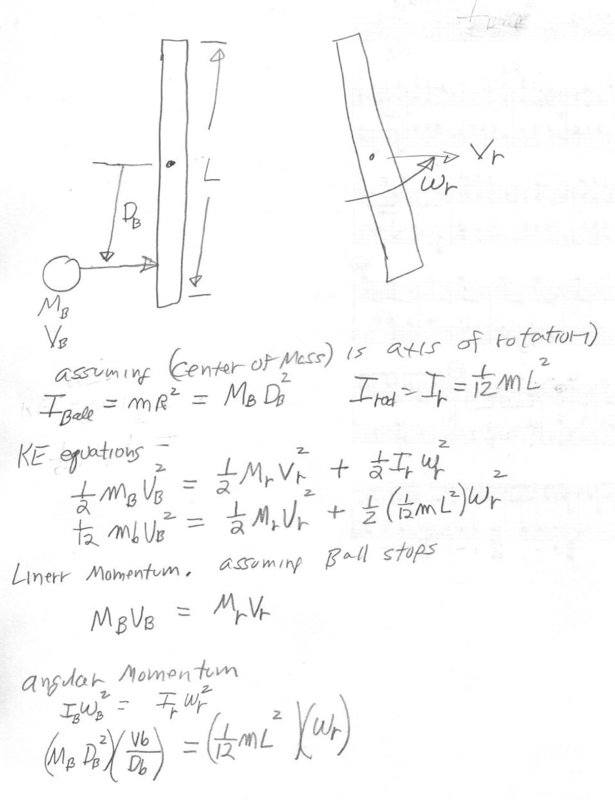

I don't understand ##D/2##. It would be simpler to introduce, ##d = D - L/2##, which is the offset from the COM.
I also don't understand the square term. The AM of a point mass is simply ##mvd## in this context.
I of the ball is mR^2 AM = I*Omega
You are correct. I have the d confused. I need to take a break and redraw my diagram and get my equations correct. Don't forget me as I shall return
I have attached an updated diagram with equations.
I think these equations agree with what we have been discussing.
I will now have to manipulate them to get the results I want.
At this point, I have forgotten what I am looking for :-)

Just for fun I assigned some values to see what I would get.
Mr = 1 kg, Mb = .1 kg, L = 1m, D = 0.4m
Vb = 10 m/sec
I calculagte Ib == mr^2 = (.1)(.4)^2 = 0.016
I calculatge Ir = (1/12)mL2 = (1/12)(1)(1)^2 = .0833
Using eq 2 I get Vr = 1
Using Eq 3 I get omega(r) = 4.8
If I put these into the KE equation, #1, I get 0.7 not close to 5 as I expected since (1/2)(.1)(10)^2 = 5.
Hmmmmmmm...

A couple of errors in there, but later fixed up, so maybe transcription errors.
In the second KE equation you start with 1/12 when you mean 1/2.
In the first angular momentum equation you have the angular velocities squared.
You are totally correct on both accounts.

You have chosen that it is an elastic collision and the ball comes to rest. That will only happen with the right relationship between the masses, but you have plugged in arbitrary masses.
Let the ball's mass be unknown. With the resulting movement of the rod, that gives you three unknowns in total. Conservation of energy, linear momentum and angular momentum gives you three equations. Solve.

It turns out that one constraint for a solution to this problem is that ##M_b \le M_r \le 4 M_b##.
Also, depending on the ratio ##M_r/M_b##, the ball must hit the rod at a specific offset ##d##. For example, if ##M_b = M_r##, then ##d = 0## and you have the (hopefully familiar) case of an equal mass elastic collision.
There can't be a solution for all variables. In fact, the ball can only stop when there is a strict relationship between ##M_b, M_r, d## and ##L##.
The one truly independent variable is the impact velocity ##v_b##.
Given that my assumed variables will not result in a stationary ball after inmpact I assume we can still solve this problem for Vr and Or after the collision. I am using O for (omega)
Using the linear momentum equation I get (0.1)(10 = (a)(Vr) so Vr = 1
Using the angular momentum equation (0.16)(10/0.4) = (.0833)Or so Or = 4.8
If we calculate the KE after the equation it is (.5))(1)(1)^2 + (.5)(.0833)(4.8)^2 = 1.45J
The KE of the ball before the collision is (.5)(.1)(10)^2 = 5J
Clearly thee is still some KE in the ball after the collision so I assume that with these variables, the ball does not come to rest after the collision. Is this correct? If so, then we can assume that the equations are correct and that the initial assumption that the ball comes to rest is wrong. I am learning a lot from this exchange.
