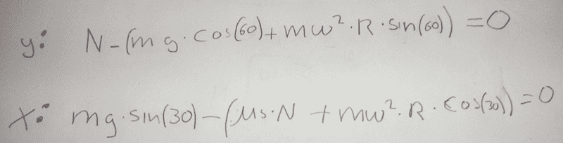

Small object of mass m is placed on the inner surface of the conical dish which can rotate with angular speed ω.
For μ=0.3 calculate the minumum and the maximum ω such that the object is remains at rest. Solve the problem using the indicated axes x-y.
Do the following steps:
(a) Show all forces acting on the object and and the acceleration
(b) Write Newton’s second law along both axes and solve.
F=ma=m*ω2*r
I have plugged in numbers and got answers for ωmax and ωmin but I don't get the right answer.
I have solved it right when I choose axis the ordinary X-Y axis but I need to know how to solve with using the other axis mentioned in the problem
The right answer is
ωmax=7.214 rad/s and ωmin =3.405 rad/s

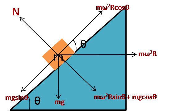

Your equation for both the X and Y direction is wrong.
You have taken the wrong component of mg and mω2r along the X direction. In the RHS, it won't be completely mω2r, it will be some component of this force. Make a free body diagram.
In my free body diagram i have the fricton coefficient on both sides because it can go both upwards and downwards.
I don't really get what I should do on the right hand side for mω2*r
I have been trying for a few hours now and I am completely lost now.

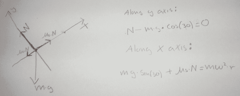

Correct!
The force mω2r doesn't act in the X direction, so you will have to take its component along the X direction and solve.
See the image below, that should help you.
Thanks very much.
I did not know in what direction the ω2 force was heading. Tried to read it in my physics book but english is not my first language so i didn't understand it.
I feel like I'm getting closer but there is something wrong in my 2 equations because I can't solve them ( because there is something wrong with them)
Can you give my a hint, Sir?
