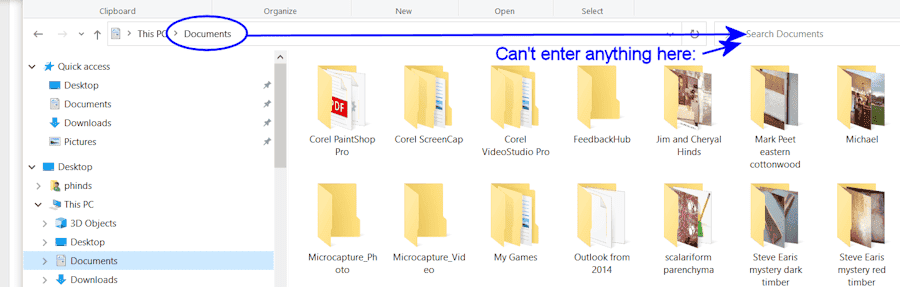

windows explorer search keeps dying
I have a serious problem w/ Windows 10 Explorer's search capability and when I look for solutions w/ Google, I see that apparently a lot of people have very recently begun to experience problems w/ the search capability (apparently due to a recent Windows "fix") but MY problem is never mentioned.
What is mentioned a lot is that search results just don't show up. My problem is that the ABILITY to do a search dies in that the text box where one types what is to be searched for stops allowing for any entry.
The only "fix" I have found is to reset the computer which is VERY annoying since I am a power user and typically have 8 or 10 apps all open. These all have to be closed, the reset performed, and then the apps reopened. Major bummer.
Anyone here seeing any problems w/ the search?

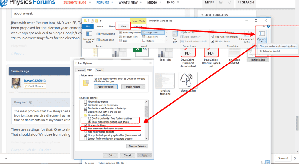

Borg said:
The main problem that I've always had since Win 7 is that they changed it so that ignores many file types that I need to look for. I can search a directory that has a single file in it that I know has the word that I'm looking for and it will tell me that no documents meet my search criteria.
There are settings for that. One to show file extensions and another to show hidden files.
That should stop Windoze from being blind to those files.
No, I know about the hidden files option. The problem is that even if you don't have files hidden, the search ignores certain extensions when it searches. There are options to undo that but I've found that they just don't work.

Just one question phinds, does this behavior of not accepting input occurs when you select an entry shown in recent search history drop-down list or it happens in other cases as well?
There is no drop-down list when this happens. When you click the search box, literally nothing happens. No cursor, no drop-down list, nothing. It's like the box isn't even there.
It doesn't matter WHAT I'm searching for because, unlike Russ, I do get the search box, I just can't type anything into it. There is no dropdown list and I don't recall ever seeing one in the past.
EDIT: OOPS. of COURSE I get a drop-down box, but only when the search box will allow input. Don't know why I didn't remember that
