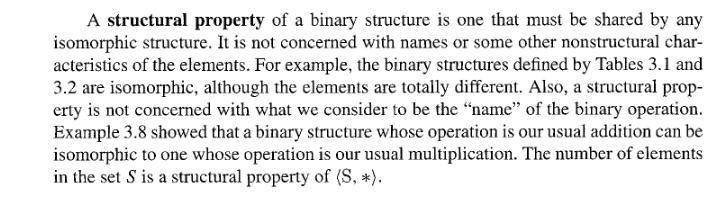

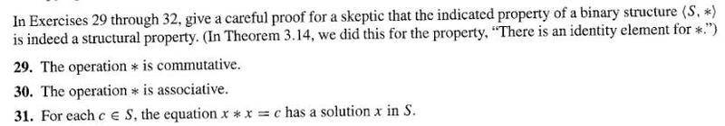

*Attached is the problem statement, along with a definition which is to be used (I feel like some of the definitions in this text are somewhat untraditional, so I am including this one for clarity).
Edit* sorry, it's problem #31.
Let <T, !> be any binary structure isomorphic with <S,*>. This means there is some bijection Ψ: S → T such that (∀s1,s2 ∈ S)(Ψ(s1*s2) = Ψ(s1)!Ψ(s2)). Now let d ∈ T. Since Ψ is surjective, there is some c ∈ S such that Ψ(c) = d. But then there is some x ∈ S such that x*x = c. As a result, Ψ(x*x) = Ψ(c) = d = Ψ(x)!Ψ(x).
Q.E.D.

This is ok, Syrus!

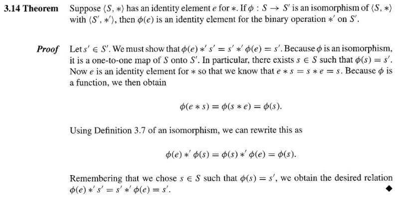

The proofs for exercises 32 and 33 are below. The original questions and other related materials are attached as thumbnails.
32: Let <T, !> be any binary structure isomorphic with <S,*>. This means there is some bijection Ψ: S → T such that (∀s1,s2 ∈ S)(Ψ(s1*s2) = Ψ(s1)!Ψ(s2)). Take b to be the identity element of S under *. Clearly, then, b*b = b. As a result, Ψ(b*b) = Ψ(b)!Ψ(b). By lemma 3.14 (attached above), however, Ψ(b) is the identity element of T under !. Hence, Ψ(b)!Ψ(b) = Ψ(b).
Q.E.D.
Shouldn't that be: as a result [itex]\psi(b)=\psi(b*b)=\psi(b) ! \psi(b)[/itex]. And doesn't the proof end here??
I don't see what you're doing here. And I don't see why you use lemma 3.14. Nobody said that (S,*) has an identity. So lemma 3.14 isn't even applicable!

Yes, youre correct micromass. It was my slip up, I can use the equivalence between (b*b) and b, along with the definition of isomorphism to show that psi(b) = psi(b)!psi(b).
Thanks again for your time.
