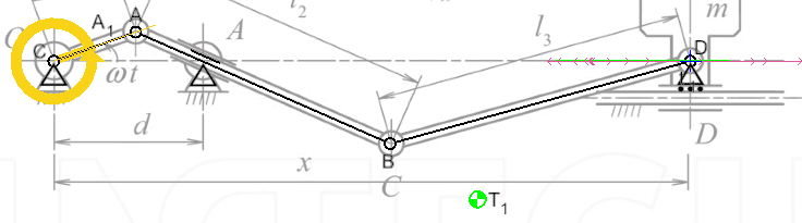

Say I have a mechanical device like this one:

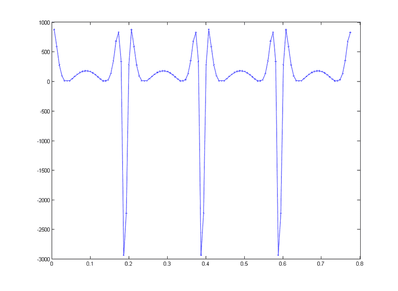

If I plot the acceleration profile at (trace-) point D I get something that looks something like this:

Can I build a device composed of one of more (eccentric rotating mass) vibration motors that when rotating will approximate this acceleration profile?
Let us assume that they can be synchronized and initialized properly (as stepper motors can).
Ideally I'd like to have as few such motors as possible.

I don't know the answer,but is it a Whitworth shaper? Asking because the acceleration profile looks so skewed.
The mechanism is as drawn in the diagram. It is not the Whitworth shaper, but it was designed to has an asymmetric acceleration profile.
You might synthesise that acceleration pattern from the Fourier components.
If you have sinusoidal harmonic vibrators that are synchronised, then you will need several harmonics to approximate the acceleration spike.

I would use an FFT to compute the most significant phase and amplitude requirements for emulation.
Seems to me that the acceleration spikes are the key and the recovery waveform is probably non-critical. So why not use an electric jack hammer or a hammer drill to make the acceleration pulses.
Then, if you need to cultivate the rest of the signal, use a simple eccentric vibrator.

Not very. Indeed, the important part is the asymmetric acceleration - higher in one direction with a slower return.
