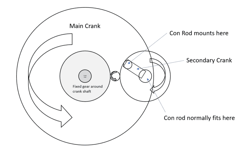

I am trying to build a dual input (double input) crankshaft, out of Lego. All the tutorials online use flywheels, but I want a strong high quality crankshaft that doesn't rely on flywheels.
The crankshaft is for a 1 cylinder or sinusoidal linear type input. This video demonstrates the flaw of the current crankshafts:

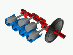

Wikipedia (gif animation) makes the crankshafts look nice, perfect and smooth. But IRL the crankshafts commonly jam like the video above if you try to use linear input.

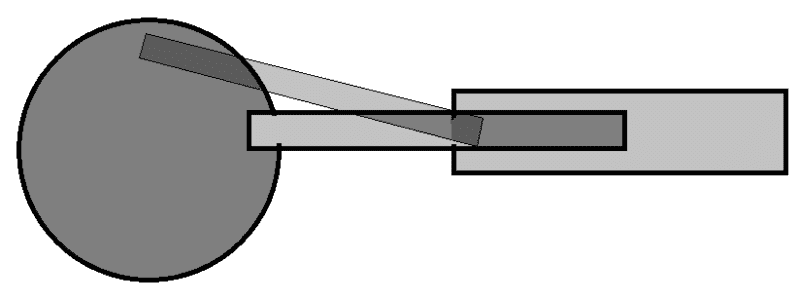

I can explain what is wrong with the crankshafts in this picture.
The arm only travels 179 degrees, the arm can never travel 181 degrees in order to get to the other side (unless the device is very precisely optimized and helped with flywheel). Therefore it only push-pulls the rotation instead of giving a full rotation. In practice, it actually gets jammed often around the 175 degree region, perhaps due to material warping or length axis torque.
Even though I see the problem, I haven't yet invented a solution. I am looking for neat ideas of how to build a better crankshaft. For instance, a Tesla valve is a neat idea for valves, I would like something equivalent in neatness to that. Something robust, not overly complicated, and efficient. The video comment section makes vague references to steam engines fixing this shortcoming, but that sounds like an air mechanism and additional power and complexity is needed, I am looking to just add a couple of extra levers or gears.

Could you show us a basic diagram of your dual input (double input) crankshaft?
I don't know how to build one yet, I am wondering if there is already something like that out there lol.

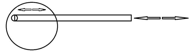

Around the 4 minute mark he demonstrates only the crank can be used as input, the piston cannot be used as input. A dual input crankshaft could use the piston as input with no jamming.

Crankshafts have a mono-input problem, around the 4 minute mark the video demonstrates how a typical crankshaft can only accept input from the crank and not the piston. Engines compensate for this by using flywheels but I am wondering if there is an alternative way to get past this without using flywheels.

Basically - not counting on rotational momentum of say a flywheel - you can pull the upstroke from the driveshaft using the momentum of whatever is being powered, or spring the bottom of the piston-head, or hinge-spring the piston-rod andor crank pins.
What's the goal ?
What's the goal ?
Hmm I will look into that, not yet sure what that would entail. Think its doable with Lego but I am wondering why that isn't yet used with mainstream engines yet. The goal is to rotate a crank shaft with only 1 cylinder, without having to add the extra weight and decreased acceleration from a flywheel.

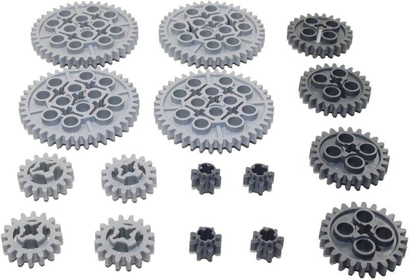

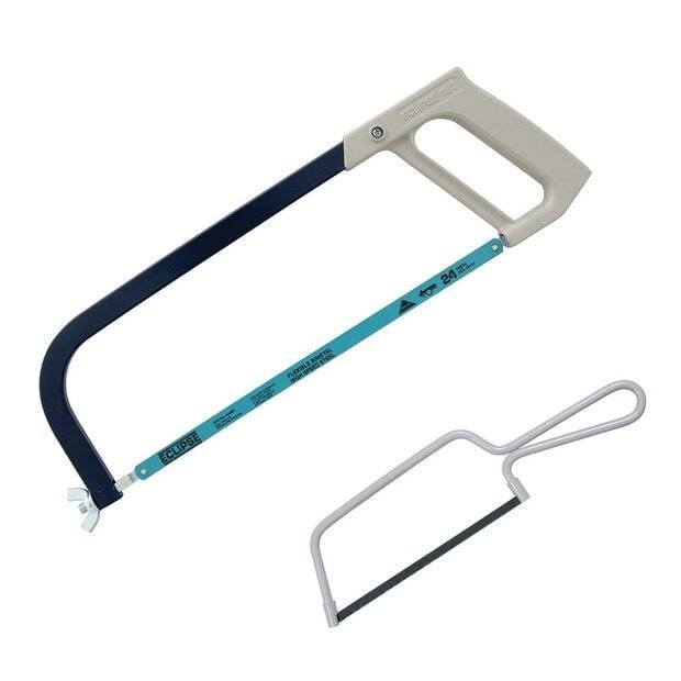

Why are you focusing only on the 'problem' of rotating from 179° to 181°? What is going to power the compression stroke from 181° to 359°? If you can solve this problem there will be enough inertia in the system to carry through the extra 2°. However this will still give you a very uneven force throughout the powertrain and this is one reason why even multi-cylinder engines have flywheels.
paradisePhysicist said:
unfortunately Lego doesn't seem to have any half-gears at the moment.
They supply them in kit form:
Thinking about these things is good, but I think you need to get some practical experience: is there any science or technology museum accessible to you where you can see working models? I am lucky enough to live a couple of miles away from some of the oldest working steam engines in the world, but other alternatives are available such as getting a pit pass at a classic car (or even better, motorbike) race meeting.
View attachment 285537View attachment 285538
I don't consider myself a Lego purist because I am willing to mix and match cadfi with other Lego technic pieces, however, cutting legos is where I draw the line. I was maybe considering paying someone to 3d print half gear legos, however the problem with Lnewqban's example is I think that particular example only accepts the circle gear as input and not the linear motion. There is another half gear configuration I discovered, but I am wondering why its not used in mainstream car engines, the problem I can see (though I'm not sure) is that if one gear slips at all, the whole system could disconnect totally, or lock up and potentially cause a disaster. The system also seems to require tooth gears and couldn't use smooth gears like a belt or other type of gear like system that has a potential to slip.

But this misses the point exactly; the flywheel is there to provide uniform rotational speed (and to store enough energy to compress the charge for the next power stroke). The flywheel prevents the loss of speed just as much as it prevents a burst gain in speed.
Some small engines (think lawn mower), will not run properly if the blade is removed. This is because the blade is required to act as a flywheel providing the energy required for the compression stroke.
