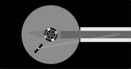

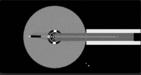

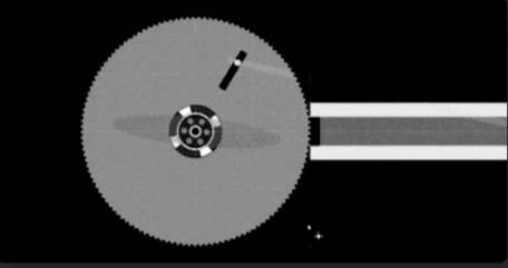

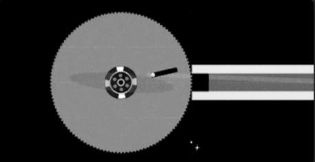

I will post gif of experiment, I don't think it will work at any length or configuration without assistance from rotational inertia (ie., a heavier gear or flywheel needs to be added.)
View attachment 285646I am looking into the one cylinder locomotive, the only website I can find is this website, which says the diagram is wrong, so I haven't figured out how they built it yet. http://www.douglas-self.com/MUSEUM/LOCOLOCO/onecylinder/onecylinder.htm
Hmm can you edit your diagram because I'm a bit confused about it.
I think you have too long a slot on the gear there. I would have the slot at 45° from the radius, and significantly shorter than that!
The goal of the motion there is that when the crank stops turning from the forward motion, when the piston pulls back the connection slides along the slot and downwards, so that it is below the crankshaft axis and therefore will now pull the crank in the correct direction.
The issue there is that the crank will be turning & stopping throughout the cycle as the con rod stops driving it and instead slides through it.
I will try to come up with a clearer way to convey my idea, but it will probably involve making an animation to explain it as it's a bit hard to picture the way everything moves! This is an adaptation of a mechanism I designed years ago to create a long linear motion from rotary motion within a confined space. It effectively doubles the piston motion for the crank diameter, and also creates exact linear motion rather than rotary for the con rod. I'm adjusting it with an offset in the idea that it would create the dual crank effect I'm trying to come up with for you!
Can you explain which design you're trying to figure out on the link, as there are loads on there, and all of them seem to involve flywheels!
Can you also explain why a flywheel is not wanted if you are trying to create an engine which will turn continuously in one direction?
Ignore that, I re-read the thread and you're goal seems to be about creating a reversible cam & slider mechanism without relying on a flywheel. I wonder if this is one of those things which may prove mathematically impossible...
I'll look forward to trying to find out...
That seems a fatal flaw for any useful slider crank mechanism.
What is 45° from the radius lol, a radius is a scalar with no angle.
I will try another configuration of that but I don't think it will work.
Yes, some efficiency will be lost with that as well.
Ok cool. Looking forward to the animation but also in the meantime you could add more labels with the diagram, with the current diagram I'm not quite sure how to build it.
Oh the design that was suggested is the Neilson one-cylinder locomotive. The only problem is that seems to be the only website I've found of it online, and the book about it doesn't seem to exist.
Yes. I don't think it is mathematically impossible, but would be interesting to see some kind of mathematical theorem or axiom saying it is impossible.

Hmmm what thread is this? Also adding a weight seems to be a bit like a flywheel lol...
I tested this in a new configuration as suggested it still locks up. The simulation is very forgiving so at first this isn't apparent, but if you test it by letting go of the throttle and only applying it periodically in bursts, then it will lock up at the 2 stagnant regions.
I think I can now define it as an axiom or more clear definition, an inherent linear-to-rotary mechanism can do full rotations without the use of momentum, a non-inherent linear-to-rotary mechanism must be boosted by momentum to do full rotations. Full rotations is kinda vague also cause you can just attach a little gear and get full rotations on the little gear, I think maybe the phrase "continuous rotations" is the ticket.
Anyway, as predicted, after looking at the graphs, the crank with the groove in it is somewhat less efficient, still does useful work though. The standard model rotates for about 53 seconds the crank with groove rotates for only 48 seconds when both start with the same velocity. Also the graph curves are not as smooth.

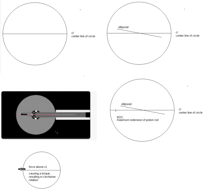

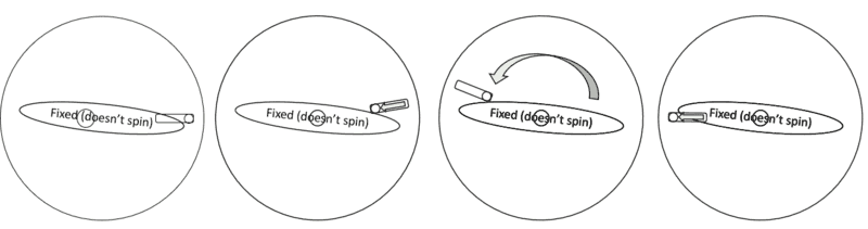

Here's a mechanism which I think would work. You could have the central oval cam (which doesn't rotate) rock back & forth to change direction.
I am imagining the piston to the right of the wheel, pushing the pin to the left. The pin interferes with the fixed cam, so cannot move past it. The pin is in a slider. The image is the 4 stages of half a stroke, and it behaves the same on the way back.
The idea is to have a mechanical movement where the first parts of the pistons stroke are converted into non-linear motion - in this case, the pin is deflected sideways by the central cam, and starts the wheel rotating anti-clockwise. At the start of each rotation, the pin slides along the cam and starts the wheel going in the correct direction.
If you're interested, this was inspired by the mechanism inside of a clicky pen, which converts repeated reciprocating motion to rotary in a similar way to what you are requesting - have a look at a transparent clicky pen and you'll see the mechanism spins as you click it!
  • #71

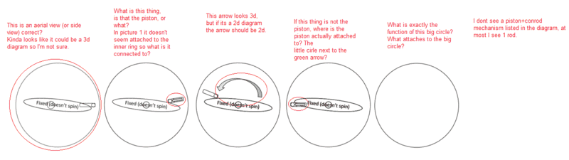

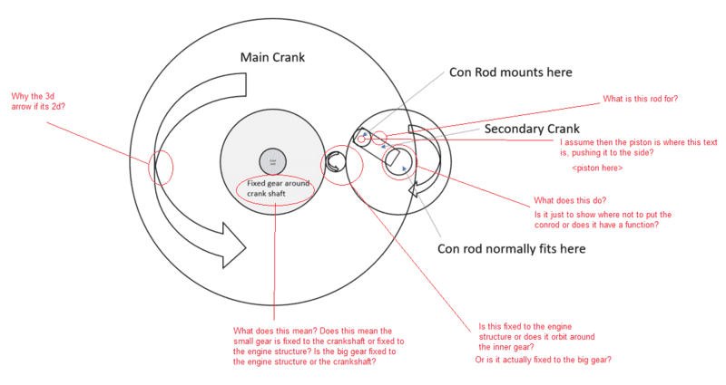

I am still not understanding your diagram lol.
These are my questions on the first diagram also:
This implies that the concept is mathematically possible.

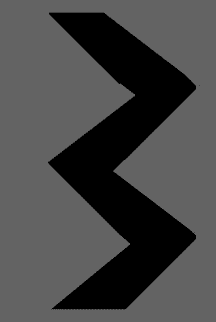

What does Charlie Brown's shirt have to do with anything ?
  • Haha
  • #73
Lol it is a 2d overlay but that is the shape you put on a 3d cylinder to give 1 way rotations (you put a disk into the slot from the piston.)

Ah, so now you're powering the piston from the crankshaft ? Or, a rotary motor connected to the zig-zag on a cylinder (or perhaps The cylinder), powering the piston through the zig-zag, thence to the crank, etc.
Were you traumatized by a flywheel as a child ?
  • Haha
  • #75
No, the piston is supposed to power the zig zag cylinder, but it could work the other way around.

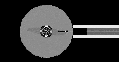

Yesterday I found a vid that overcomes 1) , haven't had time to test it in the sim yet but I think it can produce smooth or almost smooth rotational movement. The problem is that in order for it to be smooth it needs sawwave type input instead of sine wave.
I also tried to build another concept someone had, I put it in the simulation and my current implementation of it somewhat sucks, but it at least shows something like this maybe can be done.
I'll try to describe them better!
In the first one (the sequential images):
  • Yes, it's a side view, not 3d
  • That thing is a slot in which the connector can slide inwards and outwards along the radius of the crank. The circle inside is both where the con-rod would attach, and what interferes with the fixed oval cam inside.
  • The arrows were just what was available in powerpoint, don't pay any heed to their 3dness!
  • The piston does attach to the little circle, it is being pushed left & right.
  • The big circle is the crank, so it rotate about its center.
  • There's no piston pictured as it's simply pushing the little circle left and right, I didn't think it was needed to draw it! My mistake!
The second one (crank in a crank):
  • 3d arrow is not relevant, the design is drawn in 2d!
  • "Fixed Gear Around Crankshaft" means it is fixed to the engine casing and doesn't turn, and the crankshaft passes through it to reach the first crank (larger circle)
  • The little circle is a gear which is fixed to the crank, and orbits around the fixed gear as the crank turns. It turns the secondary crank in the opposite direction, with a ratio of 1:1 (so it turns once backwards whilst the crank turns once forwards).
  • "is it just to show where not to put the conrod..." that circle is the central axis of the second crank, which is attached to the first crank, so the secondary crank orbits the crankshaft whilst also cranking on its own.
  • <Piston here> Yes, that's right. The piston connects to the small circle and pushes it around.
  • "what is this rod for" - it was just visual to mark that the final conrod position is fixed to the secondary crank and not to the first.
One day I will animate this, and it will make more sense!

  • #80
I guess I am confused about the elongated ellipsoid in the middle, what is its function? Is that the central oval cam you refer to that rocks back and forth? I do not see it rocking back and forth in the image, and I'm wondering how it is connected to the pin. In the first one also the center circle seems offset from the others, I am wondering if there is a significance for that.

  • #81
Firstly, the central circle being out of position in the first one is not relevant, that's a mistake!
So, the oval piece in the middle doesn't move - it's fixed to the engine casing, no rocking or anything, it's just there to get in the way of the pin.
The pin is where the piston's con-rod attaches. When the piston pushes it to the left, the pin slides inwards on the slot (towards the middle of the crank) and it knocks into the oval cam. The oval cam being angled means this causes the pin to be pushed upwards, and this gets the crank past its initial few degrees.
From there the crank operates as normal, pushing it around to the 180° mark. As it reaches the far point, the pin slides back outwards on the slot, allowing it to clear the oval cam.
Then the process repeats in the other direction (not pictured). The pin is pulled back to the right, it collides with the cam and moves downwards, rotates the crank past the ambiguous point where it could turn either way, and starts it rotating in the same direction.

  • #84
That's a very nice animation in Post #82, but it does not work. Keeping in mind that the goal is to convert linear motion to rotary motion without using rotational inertia (a flywheel), let's take a close look at the process.
Start with the system in this position:
The pin is bottomed in the slot. The piston decelerates to a near stop because the moment arm is very small. Small movement of the piston with large rotation means that the output torque decreases to near zero.
Next, look at the pin sliding outward in the slot:
Again, the piston slows almost to a stop. The output torque decreases to near zero. And what is moving the pin outward in the slot?
Next, at bottom dead center (BDC):
There is an instant where the pin is at the extreme tip of the elliptical cam. At that instant, the output torque is zero. Since the assumption is zero rotational inertia, the mechanism stops at this point. There is a similar, but not shown, effect at TDC.
Next, the pin is sliding outward as the piston moves away from the crankshaft:
The animation shows the piston at a dead stop while the pin slides outward, and does not show what is making the pin slide outward. With the piston at a dead stop, the output torque is zero, and the mechanism stops.
These types of mechanism can be analyzed by starting at a point, typically TDC, rotating the output shaft in small steps, and calculating the position of the piston at each step. Piston velocity and acceleration is calculated from the piston positions. Piston position, velocity, and acceleration is then plotted against output shaft position. Output torque is calculated from the ratio of piston velocity to crankshaft angular velocity.
Since you are comparing this to a conventional crankshaft with flywheel, you need to do the same analysis, using the same methodology, to a conventional piston with crankshaft and flywheel. Look closely at the peak piston acceleration (about 2000 G's), and the sizes of the wrist pin, connecting rod, and crankshaft. then consider the peak loads in your mechanism and the strength of the parts needed.
While this thread has been entertaining, it's time for the OP to do some actual analysis and less wishful thinking. The OP will do an analysis as indicated above, or this thread will be locked.
thankyou
Yes but this is a universal problem with all crankshafts not just this one, when near TDC or DBC its harder to create torque.
I stopped applying input to the piston, then it is being carried by inertia. Admittedly, not the best example to prove that this device works, could have uploaded a different test run with more friction and showing the action at BDC.
That picture does not show the pin at the tip of the elliptical cam, but underneath the elliptical cam (ellipsoid). In this pic it is almost at TDC, when it is at TDC it will be underneath the ellipsoid.
I performed that analysis as requested, the device works (depending on the friction inserted and the amount of power to the piston.)
Torque can only be calculated by force, momentum, mass of the piston, not velocity alone. A crankshaft made of styrofoam would have fast angular velocity but not much torque.
I am not sure what the peak piston acceleration of a car engine is, but I am willing to consider my original comment that this could have revolutionized cars, may have been hubris. That being said, the device should in theory work, but maybe not as a car engine. A website on marine engines said 221 m/s/s which is 20x the acceleration of gravity.
http://marinediesels.info/Theory/piston_acceleration.htm
When I was analyzing this with a fine tooth comb, there was a brief moment I could see why you think it doesn't work. The reason why it works is because when at BDC when pushing the piston forwards it cannot decide to do a clockwise or counterclockwise rotation, but leading up to BDC it always chooses to do a clockwise rotation. Then when the piston retracts, it cannot decide either but the ellipsoid makes the decision for it.
that being said, when I increased the friction of the crank to 40nm it got stuck. But IRL it should work in theory if the parts are solid, well oiled and don't bend too much. How much it rotates is entirely dependent on friction and how much force is being applied to the piston. If there is too much friction it will get stuck and not rotate past the apex of the ellipsoid. This can be fixed by adjusting the ellipsoid angle more, reducing friction, or increasing power of the piston. Further optimizations could be done by experimenting with ellipsoid angles and slider lengths.
