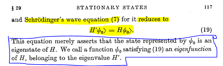

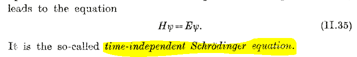

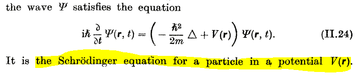

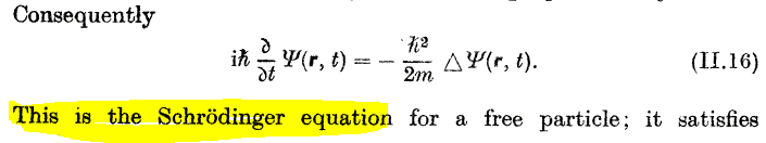

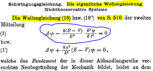

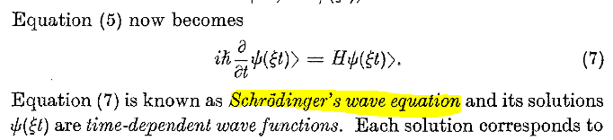

Well, here you're venturing into my territory: first, let's settle the fact that a wave equation contains a time derivative, this is selbstverständlich and even "time- independent (Schrödinger or not) wave equation" is to be treated as an oxymoron from a linguistic standpoint (in the context of the so-called standing waves, the collocation wave equation is not used). The German word Wellengleichung appears on page 510 of Vol. 79 (Zweite Mitteilung) and will design his equation 18 on page 511. After getting rid of the 2nd order time derivative by means of a complex exponential, he gets two time-independent partial diff. equations (18' and 18''). Only on the 1st page of his Vierte Mitteilung does the word Wellengleichung appear again as you can see below.
[picture courtesy of http://gallica.bnf.fr/]
Since you brought up the review article by Kemble (1929), this is interesting, because he calls "wave equation" (the quotation marks used for emphasis are his) the standard D'Alembert equation of optics. When referring to Schrödinger's work, he quotes his "4th delivery" (from which the screenshot above has been taken), p. 109 and then 4th order order equation derived by Schrödinger (No. 4, p. 110) which through simplification comes back to equation 4'' of Schrödinger (op.cit., p. 112).
On a different note, as far back as 1928, Arnold Sommerfeld published his 1st German edition of "Wave Mechanics" (translated to English in 1930 and republished in 1936). In the English translation dated 1936, Sommerfeld calls his equation (11) which contains no time derivative the wave-equation but with the bottom-of-the-page note that, I quote, "Schrödinger himself originally wished to reserve the name <<wave-equation>> for one analogous to (5) [my note, this is D'Alembert's equation], but containing the time".
So this is for the old literature. Let's turn to the "new" one of the 1950s by Albert Messiah (book originally in French, English translation 1961). I quote:
A little lower we have that:
Then lower one has indeed:
So you see, you're right, indeed it's a pretty old convention to use this historical misnomer perpetuated by physicists, no wonder the Google search results back up your assertion. So, for me and those reading me, propagating this collocation detrimentally to the more mathematical one spectral equation for the Hamilton operator should be discouraged.
In the end an excerpt from FATHER DIRAC (1958, 4th Ed. of The Principles of Quantum Mechanics)
Screenshots courtesy of original copy-right holders.
