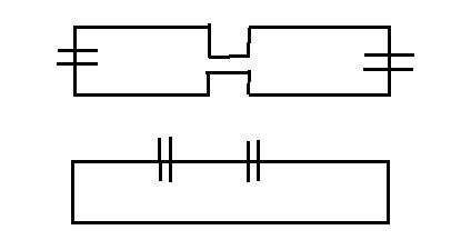

Isn't this circuit now is equivalent to this?
Schematic of two rectangular wire loops joined by a narrow neck in the middle, with capacitor symbols on the left and right sides of the upper loop, and a separate rectangle below with two capacitor symbols on its top edge.
Yes probably.
However you should label the terminals so we can be sure you haven't turned one of the capacitors around.

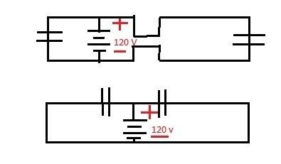

Amiras, see the attached picture. I've added in the voltage source so it becomes apparent why the two caps are in parallel.
  • Two circuit schematics: the upper shows two capacitors on the left and right joined by wires, with a 120 V battery between the top and bottom branches of the left section; the lower shows two capacitors in a single wire loop with a 120 V battery connected from the top wire to the bottom wire.
Drakkith said:
I don't see how. The first picture clearly shows the voltage source between the upper and lower parts of the circuit...

Hmm. I see your point. I thought the voltage source was located in the middle of the circuit where the arrows are prior to disconnection.
I still don't see how they could be in series. Post 3 seems to explain it pretty well. Is there something I'm missing?
