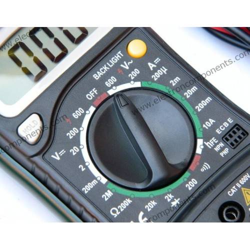

I was thinking of buying a multimeter. The one that I intend to buy is this: https://www.electroncomponents.com/Digital-Multimeter-MAS830L
I haven't used multimeters a lot. This is the dial of the one that I want to buy:
Close-up of a handheld digital multimeter with a black rotary dial, showing voltage, current, resistance and transistor test settings, plus a backlit LCD display and red and black test leads.
Let's take a specific example of the AC voltage section. It has two parts: 200V and 600V. Do these values mean the maximum possible measurable value when the dial is in that position? For example, if I try to measure 220V AC with the dial in 200V position, it is supposed to give an out-of-range error, right?
What if I measure 100V AC with the dial in 600V position? Will there be any problem with accuracy?
Similarly, what would be the result if I measure 2Ω resistance with the dial in 2M position? Are these multipliers, like the multiplier band on resistors?
The different settings, such as this one, trade off range for resolution and accuracy. If you look at the AC table section of the manual it will show you how much resolution and accuracy one loses for the wider range.

If I may just expand slightly on the information provided by eq1, can you visualise the analogue version of the multimeter (which can be purchased, of course)? The various ranges indicate the maximum that can be read before the needle hits the top of the scale. On the other hand, if you set the range too high, the needle hardly moves and so accuracy is poor. With the digital version, it can cope much better with low readings, but it is best to set the range just above what you are measuring.

A have a multimeter of same series. It is generally fine, tolerant to out-of-range input and do not require user to calculate multipliers to displayed value (accuracy may suffer if you select wrong range though). It has 2 deficiencies:
1) No auto power off, therefore battery runs out in few days if you forget to power off after work
2) Quality of short-circuit audio signal is poor, difficult to hear in noisy environments
