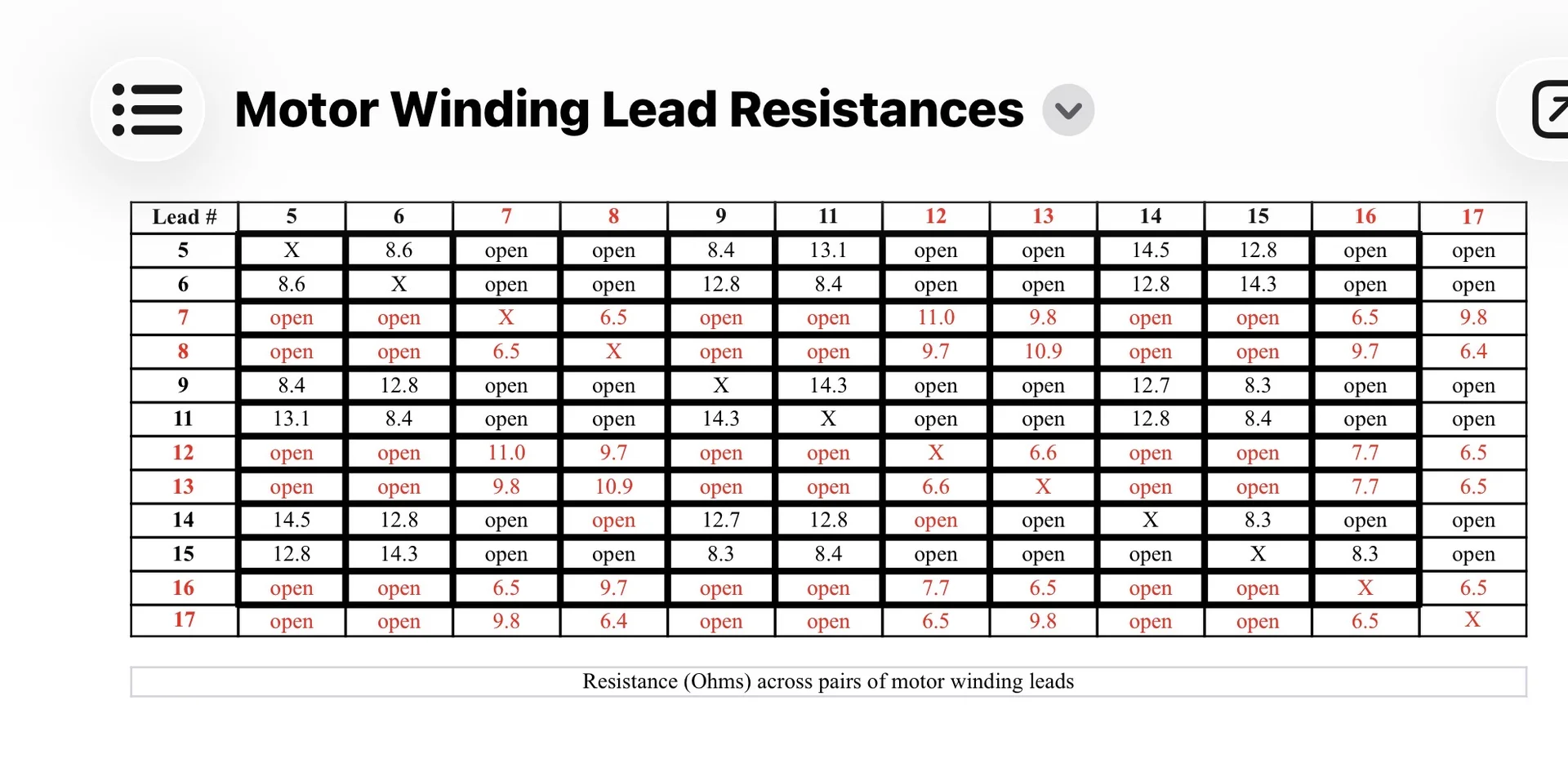

I have a stator from a 1/2 hp, four speed, 3-phase motor. Coming from the stator windings there are 12 wires (two separate sets of six on opposite ends of the motor). Unfortunately these are identified in what appears to be a non-standard numbering system and I have no diagram. One set of wires is numbered (5,6,9,11,14,15) and the other (7,8,12,13,16,17). I am trying to identify pairs so that I can wire the rest of the motor. I have determined the resistance between all possible two wire connections. Between the two groups all possible connections are open. Within each group, all possible connections show some small resistance. (I would post a table but I don’t see how to insert a picture or attach a file.)
Can someone explain how to determine which two wires are a pair?

The motor is 230v, 3 ph, 1/2 hp vintage motor madeby Oliver Machinery Company. It originally had a drum switch that provided speeds of 600-1200-1800-3600 rpm. Speculation is that it is most likely a double Dahlander winding configuration.
I suspect that there are more than 48 slots as the motor is huge, but I will have to look at it tomorrow and count them.

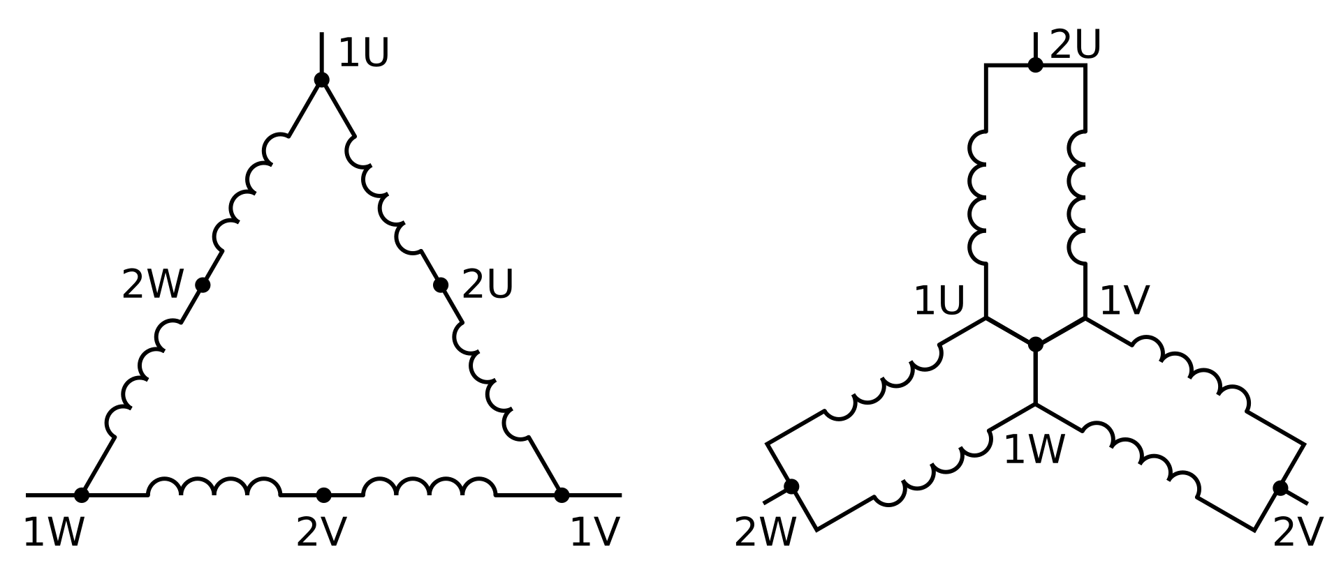

Here are the resistance readings. Any help in interpreting them would be greatly appreciated.
Table titled Motor Winding Lead Resistances with leads 5 to 17 along both axes, listing resistance in ohms between each pair or marking it open; caption reads Resistance (Ohms) across pairs of motor winding leads.
I notice you have identified two separate sets of windings, black and red in the table.
Take a look at the Wikipedia page that shows how 6 coils are connected in a ring for two speeds.
https://en.wikipedia.org/wiki/Dahlander_pole_changing_motor#Operation
The Wiki terminals are: 1U, 2U, 1V, 2V, 1W, 2W.
Likewise, one set of your terminals are connected in a ring with this order:
7, 8, 17, 12, 13, 16, 7.
From the measurements alone;
I cannot identify which is the first or the second connection of a phase, does it matter?
I cannot identify the direction of rotation, you may need to reverse the ring by swapping two lines.
Those need an experimental test.
You have something wrong with the 5, 6, 9, 11, 14, 15 group readings.
The ~8.4 ohm pairs show which other two terminals are adjacent in that sequence.
You have a ring of only 5 terminals.
It appears that terminal 14 is only connected through a single coil to 15.
While 15 is connected to terminals 9, 11 and 14 through single coils.

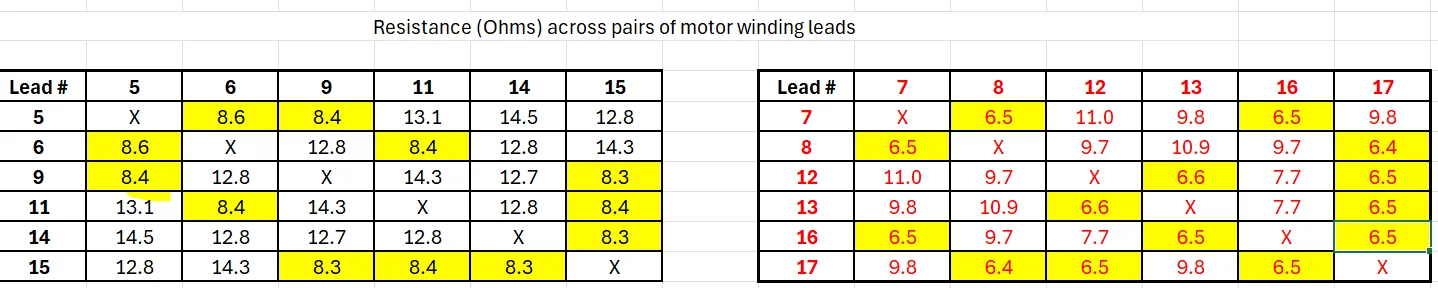

As pointed out by Baluncore, there is an error in this table. The junction of the cell representing the row 15, column 14 should read 8.3 instead of open.
It appears that terminal 14 is only connected through a single coil to 15. While 15 is connected to terminals 9, 11 and 14 through single coils.
You are correct. The junction of the cell representing the row 15, column 14 should read 8.3 instead of open.

Grubbs1960 said:
Am I to interpret this to mean that the wires labeled 7&8 are the ends of one winding, 17&12 another and 13&16 the third?
There is one winding between 7&8, another between 8&17, 17&12, 12&13, 13&16, 16&7
That makes a circuit of six windings in a loop. Have you seen the Wiki diagram?
You need to look deeper. Terminal 14 now only has one 8.3 ohm coil attached, it needs two.
Check that every terminal has two low-resistance mates.
6, 5, 9, 15, 11 is only five coils, it needs six, where is terminal 14 in the loop.
Is this still true if the 8.3 ohm value is added as described in my previous post? If so, help me understand how to “look deeper.”

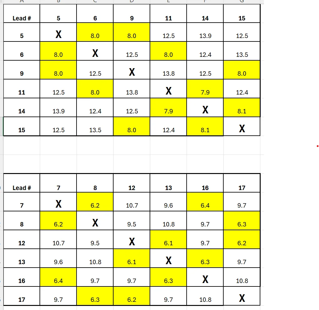

Grubbs1960 said:
If there is some additional tests that I can conduct to help verify this is a Dahlander and/or better understand the twelve loose winding ends, please advise.
I have tried to find the problems by pattern, but I am too confused, so I hallucinate false data.
Draw up your data in two separate tables, then consider each alone.
Table A, with rows and columns of: 5, 6, 9, 11, 14, 15.
Table B, with rows and columns of: 7, 8, 12, 13, 16, 17.
See the bad example at the bottom of this post.
Check the symmetry of your data by comparing all the rows against their columns.
Next practice your false Sudoku.
Find the pairs of lowest numbers in each row and column.
There should only be two distinct low values in each column.
There should only be two distinct low values in each row.
You should be able to follow those pairs of lowest numbers in a closed chain of six coils. If that cannot be done, then the data is faulty, or it is not Dahlander connected.
As an example of my Dahlander confusion.
Lookup column 6, rows 5 and 11 are low.
Lookup column 5, rows 6 and 9 are low, but we just came from 6;
So lookup column 9, rows 5 and 15 are low.
Lookup column 15, where three rows are low, 9, 11 and 14.
That is a problem because the chain must branch to 11 or 14.
11 must be wrong, since the loop would close with only 5 elements, with element 14 missing.
We have visited 11 earlier, so follow 14.
Lookup column 14, only 15 is the low, but it should close the loop of six coils to column 6.
This data is bad, it is asymmetric, or not Dahlander connected.

   12      11.0     9.7     X       6.6     7.7     6.5
   13       9.8    10.9     6.6     X       7.7     9.8
   16       6.5     9.7     7.7     6.5     X       6.5
   17       9.8     6.4     7.7     9.8     6.5     X
I have rearranged the data into two tables, as suggested. Neither conforms to the two distinct low values in each column and row. I am going to retest the leads the next time I am in the shop and will post my results. In the meantime, please find below the two tables just in case you are able to tell that the issue is not faulty data, but instead suggest some other configuration.
Two tables of resistance in ohms between pairs of motor winding leads, leads 5, 6, 9, 11, 14, 15 on the left and 7, 8, 12, 13, 16, 17 on the right, with low values highlighted in yellow.
It appears the motors are Dahlander connected, but you have three or more errors in the data.
If I assume there is only one fault in the black table, then it seems you have swapped the measurements of 14 and 15. That could have been done when measuring against wire 9, or against wire 11. Undoing one of those swaps, gives two low in each column and two in each row, with a Dahlander sequence of six wires.
If the swap was during wire 9 measurements, then the order is; 5, 6, 11, 15, 14, 9, 5.
If the swap was during wire 11 measurements, then the order is; 5, 6, 11, 14, 15, 9, 5.
In the red table, you have 14 low values, but there should only be 12. Also, the table is not symmetrical.
Column 17, row 13, should probably read 9.8, not 6.5.
But that still leaves wire 17 connected to three others, namely 8, 12 and 16.
One of those three is probably a wrong value.
To solve problems with multiple wires, you must be obsessive, continuously doubt and methodically check your work.
Below find new data, which does include only two distinct low readings in each row and column. My apologies for posting incorrect data in prior posts. Any insights this new data provides will be greatly appreciated.
(Edited to add: I believe if I have gained a correct understand of what I have learned from you that the first table indicates that the coils are connected as 5-6-11-14-15-9-5
and that the second table shows coils connected as 7-8-17-12-17-16-7. Please confirm or correct.)
Two spreadsheet tables of pairwise readings between numbered leads, with yellow-highlighted low values (about 6.2 to 8.1) and X marks on the diagonal. Top table covers leads 5, 6, 9, 11, 14, 15; bottom table covers leads 7, 8, 12, 13, 16, 17.
Baluncore said:
Now the order of the coils becomes trivial. Try the following.
9, 5, 6, 11, 14, 15. = 1U, 2U, 1V, 2V, 1W, 2W.
8, 7, 16, 13, 12, 17. = etcView attachment 373793
For slow speed connect 3PH supply to terminals 1U, 1V, and 1W.
For fast speed connect 1U, 1V, and 1W together, with 3PH supply to 2U, 2V and 2W.
This diagram is from Wikipedia.
https://en.wikipedia.org/wiki/Dahlander_pole_changing_motor#/media/File:Dahlander.svg
Thank you profusely for getting me on the right track! It will probably be next week before I actually get a chance to actually test this, but I will post results when I do.
The second table cannot have two 17s. So try 7, 8, 17, 12, 13, 16, 7.
You chose to read the order differently to my, 8, 7, 16, 13, 12, 17, 8.
As that demonstrates, we don't know the direction of the windings, or which terminal is first in the list, if it matters. That is for you to determine by experiment.
Note that listing the wire order backwards, is equivalent to swapping two 3PH lines to reverse the motor.
My second 17 in that line was a typo, I did indeed mean to type 7-8-17-12-13-16-7. At least that is what I penciled in on the wiring diagrams that I printed out from your post.
I am apparently really good at making typos.
Do I understand correctly that since these coils are wired in a loop, we can start with any coil number and list them, i.e. 17-12-13-16-7-17 describes that same coil loop? I guess at this point I am trying to understand why it would matter which terminal is first in the list from the standpoint of connecting the windings. Does it have to do with some physical aspect of where the connections need to be made. I am still not clear on what you mean when you say that is for me to determine by experiment, nor what experiment to conduct.
I do understand this.
Yes, but you need to be more obsessive when it comes to data tables. That loop only has 5 coils because you skipped wire 8. Try: 17, 12, 13, 16, 7, 8, 17.
Because in the double Y mode there is cancellation of three poles. Hopefully, there is a symmetry that saves you. I don't believe it matters which coil is first for the standard Dahlander, which elegantly gives the same power at the two different speeds. I may be wrong, in which case it will show in your experiments faster than I could demonstrate it did, or did not, matter in theory.
There is however, an equal torque at both speeds version of the Dahlander motor that, if you get the starting coil wrong, will suffer an immediate internal short, blowing the external fuses. According to your resistance measurements, your motor appears not to have that type of connection.
