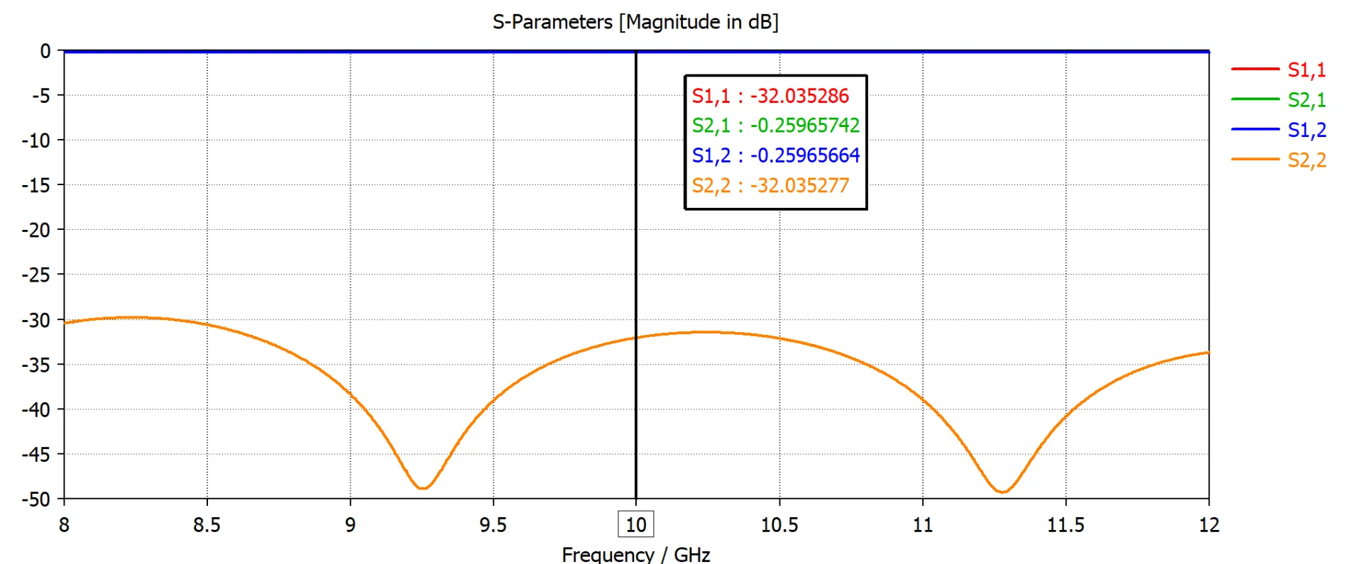

Hello , I have simulated a basic two situations.

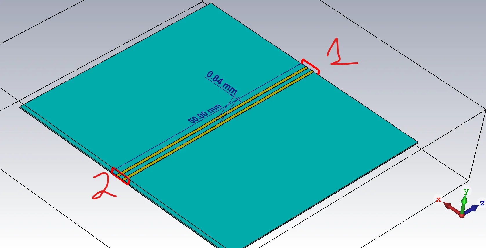

The first is straight differential line.

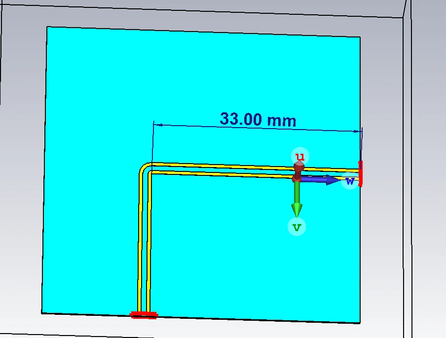

The second is curved differential line.
The excutation is differential + - on the lines so the S2p is differento modes.
in the curved pair line we have a situation where one line is longer then the other.
Two questions:
1.the S2p is differential mode excitation.
how can i investigate the idial straight line and the curved line touchstone files and see the difference
Two questions:
1. what is the proper way to investigate the idial and curved lines touchstone files given the differential excitation and see the missalaighnment.
2. is there a manual I could use to fix the missallighment in the curved differential line.
Thanks.
  • CST simulation view of a differential pair trace on a cyan substrate, with a right-angle bend; a dimension arrow above the horizontal section reads 33.00 mm, with u, v and w axis arrows marked.

  • Plot of S-parameters magnitude in dB versus frequency from 8 to 12 GHz; the S2,2 curve dips to about -49 dB near 9.25 GHz and 11.3 GHz, while S1,1 and S2,1/S1,2 curves are near 0 dB.
  • Graph titled S-Parameters [Magnitude in dB] plotting S2,2 from 8 to 12 GHz, dipping to about -49 dB near 9.25 GHz and 11.3 GHz, with a legend box listing S1,1, S2,1, S1,2 and S2,2 values at 10 GHz.

  • CAD render of a flat differential microstrip pair on a dielectric substrate, with two yellow traces running diagonally and labeled gap 0.84 mm and length 50.00 mm, and red-marked port locations 1 and 2 at each end.

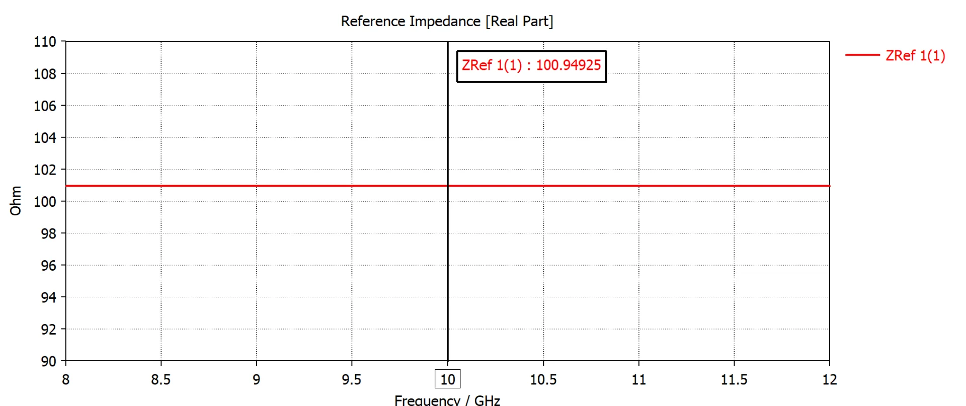

  • Line graph titled Reference Impedance [Real Part], plotting ZRef 1(1) in ohms against frequency from 8 to 12 GHz, a flat red line at about 101 ohms with a marker at 10 GHz reading 100.94925.

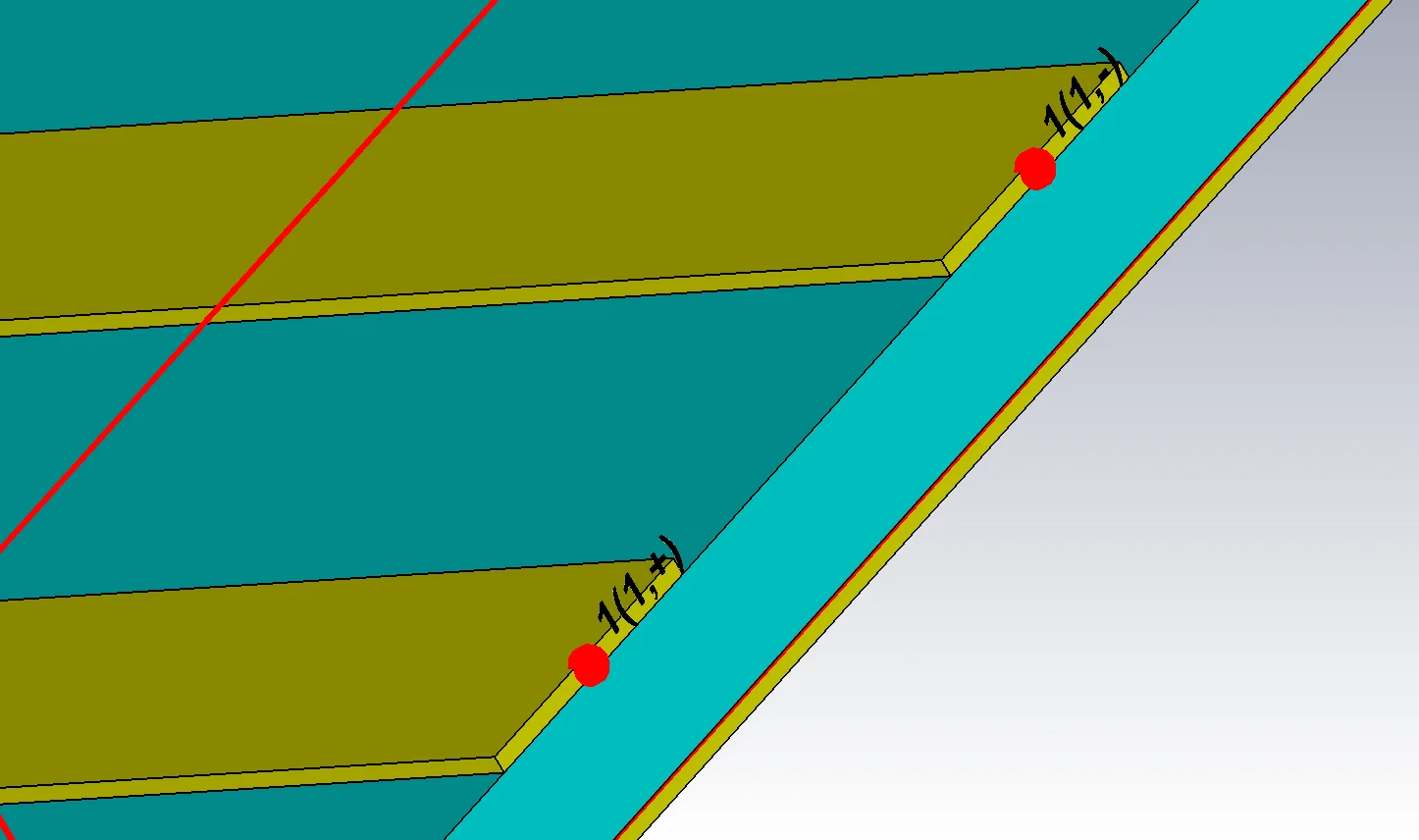

  • Simulation screenshot of a curved differential pair of microstrip traces on a teal substrate, with two red port markers labelled 1(1,+) and 1(1,-) on the edges and a red reference line crossing the view.

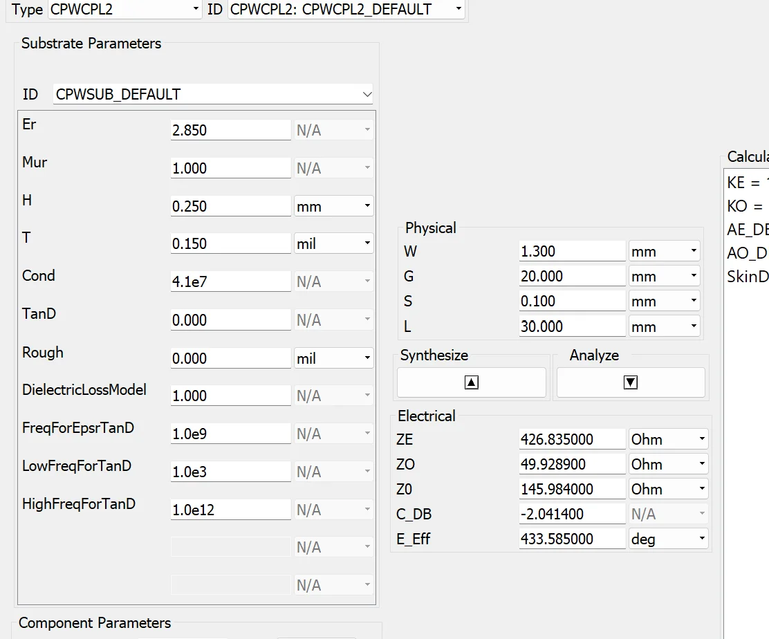

  • Screenshot of a CPWCPL2 coupled coplanar waveguide calculator dialog listing substrate parameters Er 2.850, H 0.250 mm, T 0.150 mil, and physical parameters W 1.300 mm, G 20.000 mm, S 0.100 mm, L 30.000 mm, with electrical results ZE, ZO, Z0 and E_Eff.
