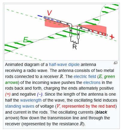

I don't know if it will help your intuition, but check out the animation of a dipole antenna at this Wikipedia page:
https://en.wikipedia.org/wiki/Dipole_antenna
It shows how the currents flow in the antenna wires and how the charges flow to generate those currents. It also shows how those charge movements and currents launch the EM wave that flows away from the antenna (at the speed of light). The animation says it is for receiving an EM wave, but the process is pretty much the same for transmitting as receiving.
