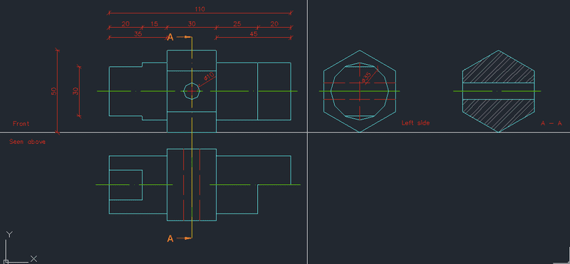

I'm drawing in Autocad some object for a my autocad class.

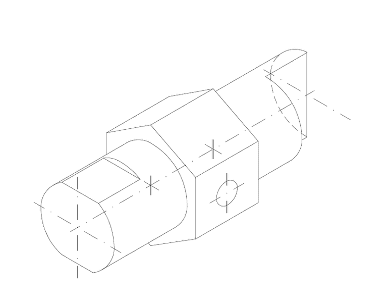

I'm supposed to draw it using the 3-D picture as a model
The model
This is what I have drawn.
I saw just wondering if the object I'm drawing is ** described well enough** with these drawings I have done?
I think you need to draw a view of the right hand side. For example you can't tell if the the section at that end is round or square.
