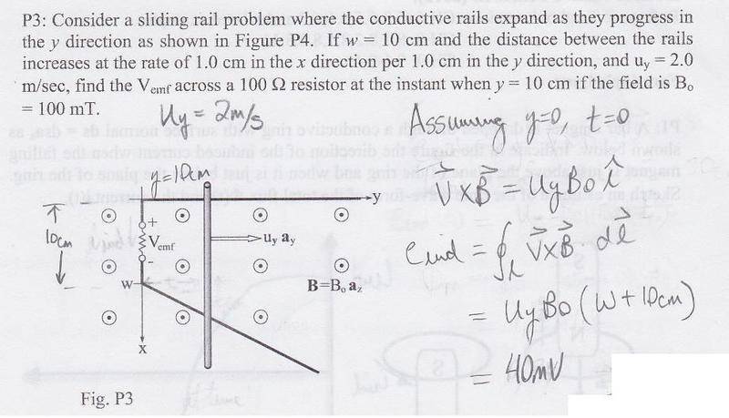

See the figures attached for each of the individual problem statements.
I'll start by explaining my concerns for each problem,
P1) Did I plot the Iinduced waveform correctly? I'm having some trouble picturing what the waveform of the magnetic flux would be, it seems to me as the current would increase as the flux increases so it should follow from the current waveform somewhat, correct?
P2) Is my expression for Vemf(t) correct? Is the expression I wrote down for the average power delivered to the load resistor correct?
P3) Again, I'm not sure if I've done this problem correctly, can someone check my results?
Thanks again!

  • Handwritten solution beside Fig. P3: a rail sliding problem with a 10 cm wide rail, uy = 2.0 m/s, and V = uy Bo (w + 10 cm) = 40 mV, with the cross product v x B = uy Bo x-hat written out.

Bump, still looking for verification on the other questions.
