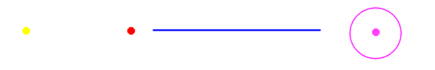

Mars is roughly 1.52 AU from the Sun and Jupiter is 5 AU. The asteroid belt, including periphery groups, extends from 1.78 to 4.2 AU.
Graphically, it would look something like this, with the red dot being Mars, the magenta one Jupiter and the blue line the asteroid belt.
So the asteroid belt includes most of the orbital radii between Mars and Jupiter.
In addition, the circle surrounding Jupiter represents its "gravitational sphere of influence". This is distance from Jupiter where its gravitational effect begins to exceed that of the Sun's.
So there are only fairly small "gaps" between Mars and the belt and between Jupiter and the belt. Object's placed there wouldn't likely be stable for the "long term". But "long term" means a something a bit different in astronomical terms vs. human terms. For example, the orbital precession of planetary orbits is measured in fractions of degrees per century.

That last graph helped a lot. I realize I was visualizing the asteroid belt as a thin layer (radially)) between Mars and Jupiter, which was wrong, so the graph there helped to correct that the asteroid belt really does extend, comparatively, from Mars to Jupiter.
