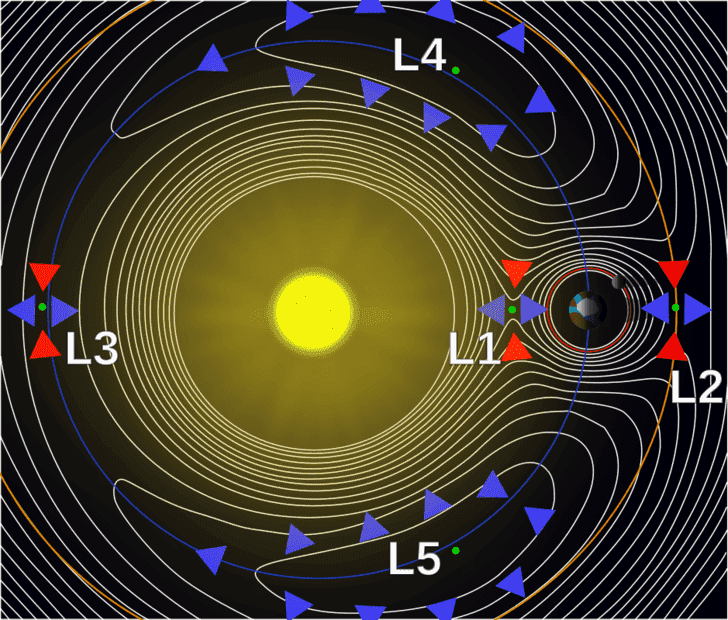

What is that a plot of.
It's just an oblique angle of the same diagram, showing potential a little better. Doesn't really address your concerns

excep that way I see it L2 is the lowest potential on the map are these not potential maps?
It would seem the literature has it that L1 is the lowest, just as these diagrams indicate.
Surely that makes sense; L1 is deeper in the Sun's gravity well than L2. You'd have to get a boost of energy to lift a satellite from the sunward side of Earth to the spaceward side.

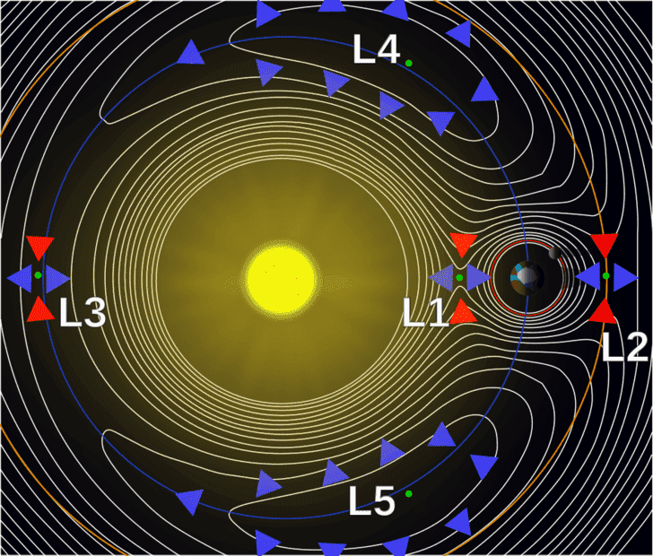

Integral said:
IF you look at the caption for that it claims that it is a plot of potential and centrifugal force. How do you do that?
You add the gravitational and centrifugal potential.
Integral said:
I am not sure what this is a plot of but it is not a potential plot of the L points.
It is the total effective potential in the rotating reference frame, where both massive bodies and the L-points are at rest. That is the reference frame where you have a time independent effective potential, so you can visualize the initial acceleration of bodies released at rest in that frame based on the slope of that potential. But as soon they start moving the Coriolis force kicks in, so the objects will circle around on plateaus, instead of directly sliding off them.
Ok so it is not a gravitation potential plot. That needs to be made very clear. Now the existence and location of the L points do not depend in any way on this centrifugal potential. They are completely determined by the 2 body sun Earth system. Seeing the raw gravitational potential plot would make the L points more understandable. The main thing this plot does is erase L2. The function of the centrifugal force is not explained well. Why do I say that? There are to many people thinking that if you drop the central force the body will then fly off in the centrifugal direction. This is a misconception that this model fosters. This plot is nearly misinformation since it it just not clear what it is. Why not just analyze it as a central force problem. We know the central force, sum of Earth sun. We know the period, 1 yr. now algebra you way to a radius.
L points are the stationary points of the effective potential (gravitational + centrifugal) in the rotating frame
No it doesn't. L2 is clearly a stationary point (saddle).

I'm a bit confused, but I'm used to it. First this rendering, to my eye, is upside down
DaveC426913 said:
Did this oblique view a few years ago. View attachment 297124
The correct pseudo potential has Earth and sun on "mountain tops" because of the centrifugal barrier. The blue arrows point uphill the red downhill vis

A.T. said:
In the rotating frame that is what happens.
And this all seems pretty straightforward to me once you get the signs right. Am I missing something?Fromthe Wikipedia ar
You are confusing two types of "effective potential":
1) Test body orbiting a single massive body - rotating frame with the same angular velocity as the test body
2) Test body in a system of two massive bodies- rotating frame with the same angular velocity as the two massive body system, but independent of the test body.
Centrifugal barrier relates to 1) but L-points are stationary points in 2), which is what the diagrams show.
Yes thank you I misspoke. The Wikipedia diagram is fine (but I think @DaveC426913 diagram is misleading at least to my eye). I agree with you and was trying (badly it turns out) to illuminate seeming areas of confusion.
So why the out-of-ecliptic oscillation? Does this serve to "average out" the perturbations?
As in: you think it's inverted?
I think it's a valid visualization as a model of objects tending to roll downhill. No?
They are equivalent. You are misinterpreting the Wikipedia diagram:
All arrows (blue & red) point downhill. I think the different colors are just used to emphasize the difference between maxima and saddle points.

A.T. said:
Yes, and in this potential there is no "centrifugal barrier".
Yes. Thank you, it finally sank in...don't know why that was so hard. And at my age I can always blame a small cerebral event. Thanks again !
