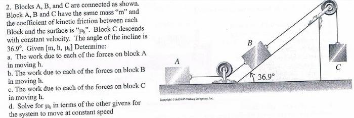

Can someone check if my Sum of All Forces is setup correctly?
Problem:
Diagram:

and all ma = 0 since velocity is constant
By the way: Why 30° ?
