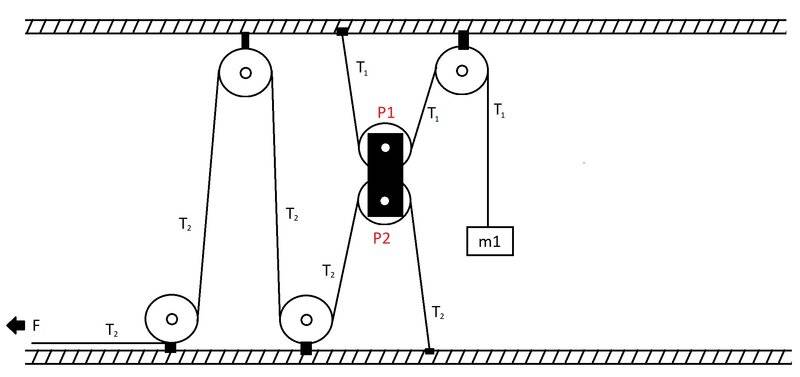

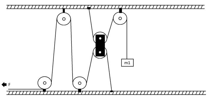

Find force F
m_1 = 5kg, g = 10 m/s^2
The following system is at rest with a block of mass m1 = 5kg, and a force F that is applied to the end of a string attached to the pulley system. Let g, the acceleration due to gravity equal to 10 (for simple calculations).

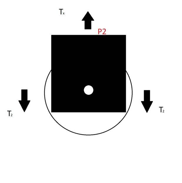

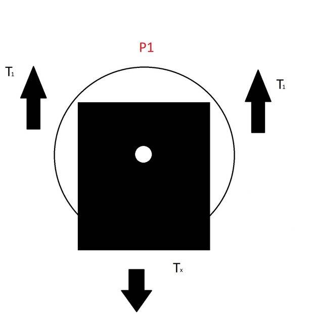

My analysis is as follows:
I'll first label the strings Tsub1 and Tsub2, and each pulley in red P1 and P2 (in red):
From here I'll make 3 free body diagrams:

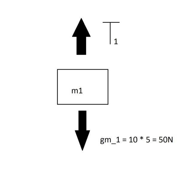

m1:
$$\begin{array}{rcl} & T_{1} = gm_{1} = 50N \\ \end{array}$$
then P1:
$$\begin{array}{rcl} &T_{x} = 2T_{1} \end{array}$$
then P2:
$$\begin{array}{rcl} &T_{x} = 2T_{2} \end{array}$$
From these equations we have that
$$\begin{array}{rcl} &T_{1} = T_{2} \end{array}$$
and therefore
$$\begin{array}{rcl} &T_{1} = T_{2} = F = 50N \end{array}$$

Sorry, I just wanted to know if my reasoning is correct. Im just a simple man trying to figure out stuff on my own without any formal training. In fact, I didn't even took physics in highschool, back in the day it wasn't required on my 3rd world country.

If you do/don't have formal training, your free body diagrams look well done/reasoned to me.

Your reasoning is correct. I wish that more of my students explained theirs as clearly as you did.
