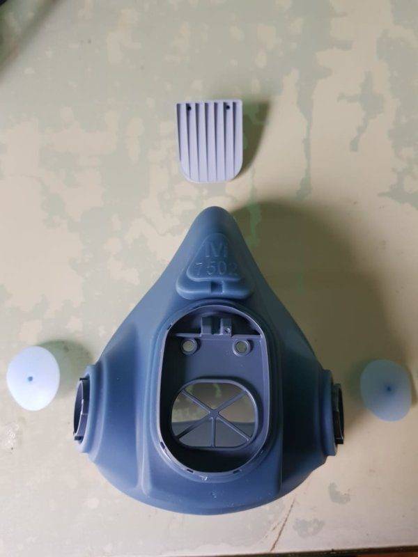

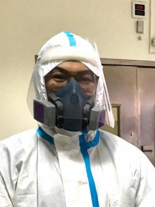

This is an ER doctor in New York with a respirator with cartridges.
Due to shortages of the N95. There are hundreds of doctors in my country using them too. I even bought one. But I noticed something dangerous. The exhalation valve has only a thin rubber flap that moves when you talk or exhale (see pictures below). If the person wearing it is COVID-19 positive, can he/she spread the virus in the ER to the patients without covid?
I actually discussed this with a brain surgeon who was also using it. Then she realized only a thin flap stands the way between the wearer and outside, and there is not even any filter. There are hundreds of others who may not be aware of this.
I'd like to confirm it with people familiar with this. Can the exhalation valve of this indeed let out viruses from the wearer? If it really can. I will warn the hundreds of doctors and frontliners using it in my country. They may be releasing more viruses into other patients.

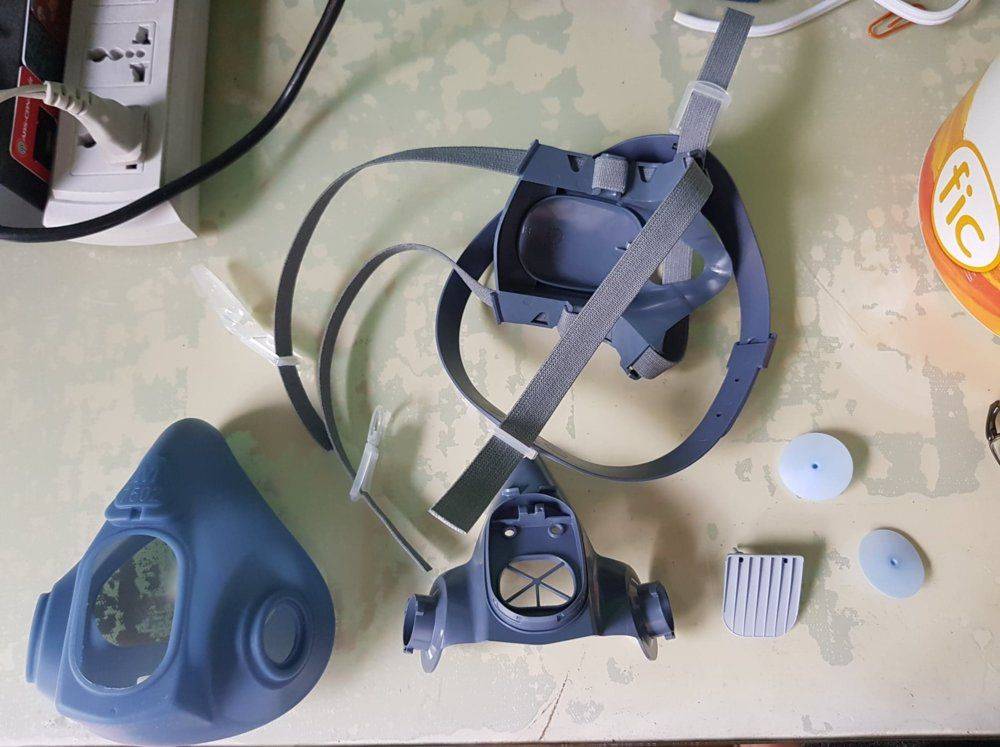

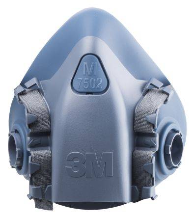

This is the breakdown of the units:
Grey-blue half-face respirator with a central "M 7502" label on the front, two side cartridge connections, and adjustable strap tabs on each side.
Disassembled half-face respirator on a table: blue rubber facepiece with a cartridge port, straps, a small round exhalation valve disc, a valve cover with ribs, and a second valve disc.
Blue half-face respirator body with a printed 7502 model label, a round filter cartridge connector on each side, and a central inner opening, with a separate grey exhalation valve flap and two blue cartridge caps on a pale table
Close-up of a grey respirator's exhalation valve cover, with a circular opening showing a dark thin rubber flap and grille, and partial printed lettering on the grey shell.
The small thin rubber flap at center above moves out when you speak or exhale inside the respirator. What if the wearer is Covid positive and exhale or cough out? Can the virus be released directly into the lying patient below the doctor or frontliners (like below actual) wearing it?
Person in a white disposable coverall wearing a grey half-face respirator with purple cartridges, a clear face shield and a white hood, with blue tape on the hood and collar.

The short answer is probably yes.
Since there is no filter on the out-going air the only entrapment of exhaled virus would be if virus particles stuck to the inside of the mask and other exposed surfaces.
This is similar to the situation in a previous post somewhere around here where filtered air was being pumped into a face mask or helmet of some kind. Its great for protecting the wearer but does not prevent spread from them to others.
Therefore it would seem to only be appropriate for confirmed non-infected people (if that exists).

Your original picture showed an ER doc with a one way valve mask. My point was that his primary objective is different from that of the the general public for whom a surgeons mask makes perhaps more sense.

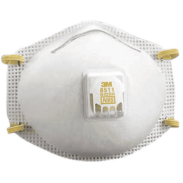

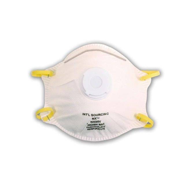

The N95 masks worn by healthcare workers. Many have unfiltered, valved exhaust. Very bad if the nurse is an asymptomatic carrier.
White cup-shaped respirator mask with a central exhalation valve and four yellow strap loops, printed with INT'L SOURCING, NX, NX95V, NIOSH N95 and PARTICULATE RESPIRATOR.
Not only that, the exhaust hole points outward. At least the masks in discussion when this thread started have a downward pointed exhaust hole.
Yep! Still wouldn’t want to be in the same viral cloud as an infected nurse with one of these.
The nurse wears the mask to protect himself. He is not attending church, he is dealing with a sick person!1! This is not complicated....
Exactly! Would you remove your N95 in the presence of an infected asymptomatic coworker wearing one of these? Bet you wouldn’t think twice! Cough! Cough!
No. Your ER coworker is also festooned with potential contamination, so I don't do not know what the big deal is. No you would not.

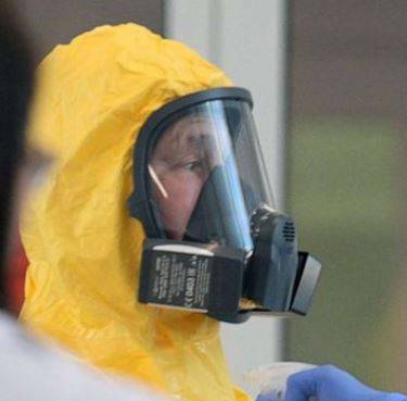

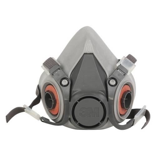

So these masks with direct exhalation valve direct in front are dangerous because it can spew out contaminated breath? There are no less than 70 frontliners in ER using these in our hospitals. They don't know the dynamics of breath flow.
Half-face respirator with grey body, two orange-rimmed cartridge filters on the sides, a central exhalation valve cover with the 3M logo, and adjustable straps.
Person in a yellow protective hooded suit wearing a full-face respirator with a large clear visor and a filter canister on the side.

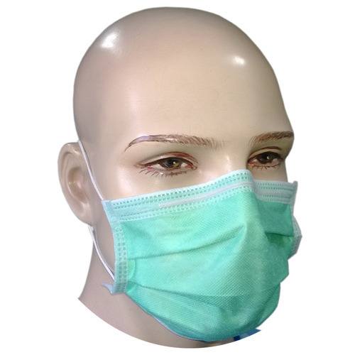

Before I warn our government about this. I need to know what happens in ordinary surgical masks used by millions of our populations in lining up at groceries or markets 1 meter apart.
Photo of a bald mannequin head wearing a light green pleated surgical face mask with white ear loops, shown from a three-quarter angle.
When one coughs in surgical masks. So the spew is trap in the masks. But what about the sides. How many percentages of particles can escape from the sides and what are their velocity and distance?
How about an N95. When one coughs inside N95. Where would the particles escape compared to the surgical masks?

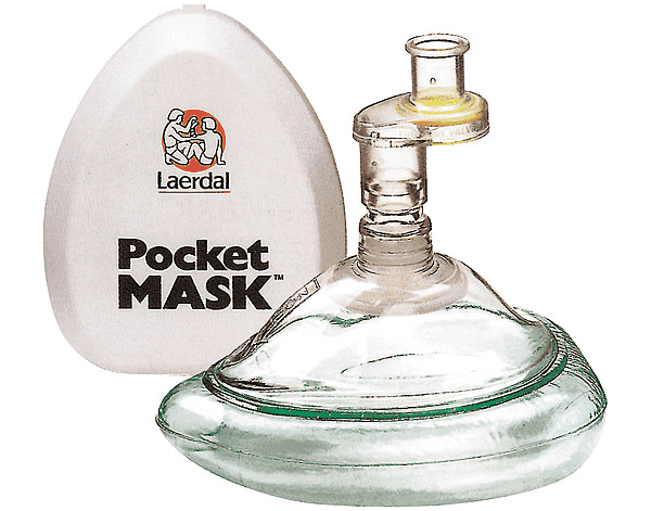

Yeah, I don't know of any that do that yet. And IMO that would be weird, and part of a very difficult end-game for humanity. "We need to treat you, but we are contagious, so we are using bi-directional PPE"...
AFAIK, respirators with filters like that are 1-way to protect the provider. And as a practical matter in my experience simple N95 masks let some of our breath out during our expiration, but seal better during our inspiration. It looks like the newer versions this year seal tighter, but their focus is still to protect us providers on inspiration.
Just think about CPR masks... They use 1-way valves to let my rescue breaths pass into my patient (Pt). My Pt catches any respiratory diseases that I'm carrying when I do CPR on them... (which will generally be none, obviously).
https://www.dsi-nj.com/newsite/wp-content/uploads/2015/09/pocket-mask.jpg
Laerdal Pocket Mask CPR barrier device beside its white clamshell carrying case, with a clear dome-shaped face mask and a one-way valve on top.

Ive been trying to analyze this for an hour. Imagine the person coughs into a surgical mask. The mask can stop the droplets as they say. But what about the breath that escapes from the sides. I don't know the physics of particles and air. I am visualizing as the droplets hit the mask fabric. It is trap there. Or could the droplets richochet from the fabric? If we are talking about bullets ricocheting a wall. It can happen. But droplets ricocheting fabric? Can it happen. If not, then the breath that escapes are already pure?
This article is relevant: https://annals.org/aim/fullarticle/2764367/effectiveness-surgical-cotton-masks-blocking-sars-cov-2-controlled-comparison
"In conclusion, both surgical and cotton masks seem to be ineffective in preventing the dissemination of SARS–CoV-2 from the coughs of patients with COVID-19 to the environment and external mask surface."
"Of note, we found greater contamination on the outer than the inner mask surfaces. Although it is possible that virus particles may cross from the inner to the outer surface because of the physical pressure of swabbing, we swabbed the outer surface before the inner surface. The consistent finding of virus on the outer mask surface is unlikely to have been caused by experimental error or artifact. The mask's aerodynamic features may explain this finding. A turbulent jet due to air leakage around the mask edge could contaminate the outer surface. Alternatively, the small aerosols of SARS–CoV-2 generated during a high-velocity cough might penetrate the masks. However, this hypothesis may only be valid if the coughing patients did not exhale any large-sized particles, which would be expected to be deposited on the inner surface despite high velocity. These observations support the importance of hand hygiene after touching the outer surface of masks."
About this "turbulent jet due to air leakage around the mask edge". Again my question in previous message, can't the particles get deposited in the surgical mask fabric even with turbulent jet, or does it mean the particles swirl around without touching the fabric and goes out? This is key to understand surgical masks leakages.

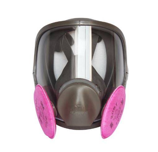

After reading the above about lack of masks that filter both inflow and outflow. I immediately went ahead of the order of the full face respirator from china whose stocks are getting so scarce.
Full-face respirator with a smoky tinted visor, a central grey filter housing, and two pink round cartridge filters on each side, with a printed model number on the right filter.
I plan to use it when going to drug store or clinic. Initially i didn't want to get it because people may complain there is no filter in the exhalation valve. But then since surgical mask and N95 also allows exhalation outside it. Then they are similar.
This is why I want to know how exactly the surgical mask behave so I can justify using it. Also because N95 are getting so expensive and scarce the public no longer use it. What do you think will allow more exhalation out, the full face respirator above or a typical surgical mask? Bill. Please answer this.

  • Full-face respirator with a dark grey body, a large clear visor, and two pink filter cartridges on the sides, with a central exhalation valve below the visor.
