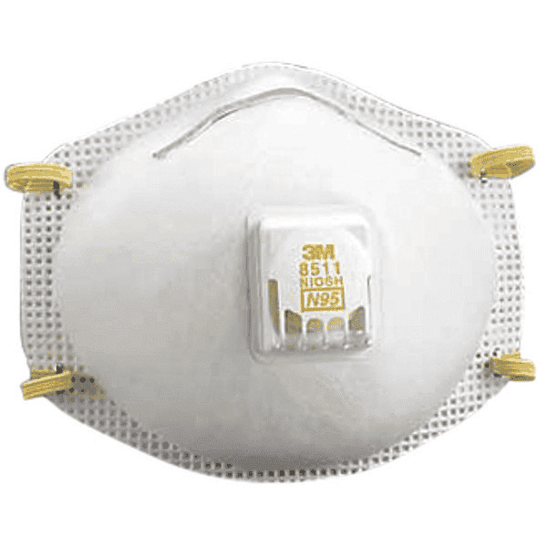

In an EMS meeting that I was in today, an MD called out a picture of a medic wearing an "N95" mask that had a visible valve on it. He emphasized that such masks with valves like that have a 1-way expiration valve, which exposes your patient to your breath if you are pre-symptomatic for COVID-19.
https://www.zoro.com/static/cms/product/large/Z-519yfo9x4.JPG
White cup-shaped respirator mask with a yellow-labelled exhalation valve on the front; the valve cover reads 3M 8511 and N95.

BTW, the MD made a semi-humorous comment about the picture of the health provider wearing the mask with the expiration valve -- "When EMS has to go to Home Depot to purchase emergency supplies, you end up with compromises like this".

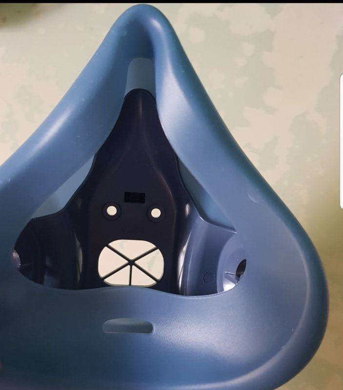

I have tried to seal the exhalation valve of the half face respirator but it becomes more difficult to exhale. I can do it partially with the breath deflected to my neck. Would this perform similar to the surgical masks? I mentioned surgical masks because n95 are now so expensive and scarce, the public no longer use them. So i need to compare the half face and full face respirators to surgical masks only, not n95.
How do you compare a surgical mask only to the half or full face respirator as far as exhalation is concerned? Which has highest score or lower score. This is the hole in the half face respirator (which is similar to the full face respirator) with a small thin rubber flap shown in my original message)
Interior of a blue half-face respirator showing a dark inner valve housing with two small round posts, a small rectangular slot, and a white circular exhalation valve with a cross-shaped flap.

No. Put on your cloth surgical mask. Then put on your respirator.

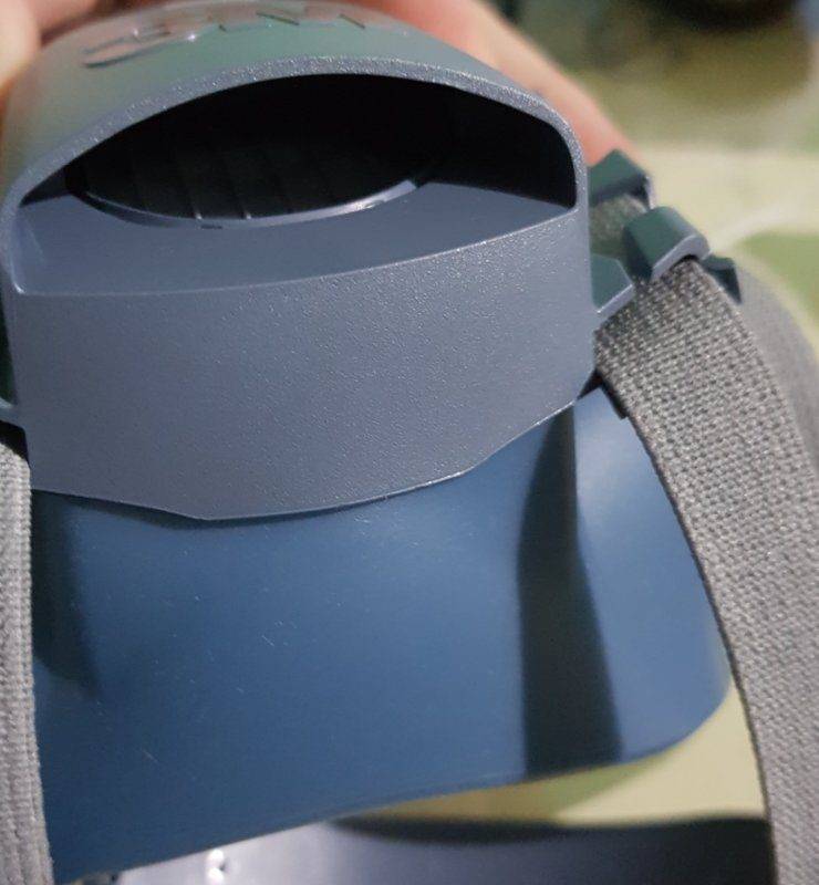

To protect myself and others. Just want something to protect my eyes too. The half face and full face respirators are air tight and inhalation is only via the filters so this is the plus side uncontroversial. The only concern is exhalation.
However my half face respirator has deflector downward. So the shield can take the droplets, and not direct to the front. So pls help reanalyze why a surgical mask only is still superior to it?
Close-up photo of a grey-blue respirator with a black exhalation valve on its front and a grey elastic head strap attached at the side.

If your respirator does not have eye protection built-in, wear goggles.

Wakarimasen...

@berkeman suggested wearing a cloth mask under your respirator if you are concerned about infecting others. Would it work to just get some cloth and tape it over the opening? That would at least catch droplets, and would be ok until it got wet (ie. like a cloth mask outside, instead of inside the respirator)?

What I mean was instead of wearing a mask under your respirator, why not take some cloth and tape it over the respirator exit?
The proper analysis needed seems unavailable at the moment. The paper you posted in #28 gives evidence that neither a surgical mask nor a cloth mask will protect others from a cough at a distance of 20 cm. However, they did not exclude that the surgical or cloth mask might reduce the distance that droplets can travel. If they can do that, then the surgical or cloth mask would still protect others when combined with (1) not going out unless you feel well, ie. no symptoms, not even mild ones, so that if there is any spread it would be either presymptomatic or asymptomatic spread (2) social distancing as much as possible, avoid going out unless necessary, ie. talk to others and receive/hand them packages at 1.5 m apart (3) wash your hands before and after handling and cleaning your mask.
