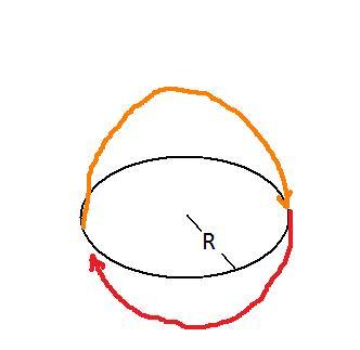

Suppose I get a ring [circular] of radius R... then it's circumference is 2πR okay?
Then how could someone create a sphere? just roll it by an angle π around itself [check attachement]... But if I say so, won't the area be [itex](2 \pi R) \times (\pi R) = 2 \pi^{2} R^{2}[/itex] ?
then one could say that each point on the circle is not going to cover a πR rotation, but a πr (r<R) ... double time because for each point which covers this rotation,there exists a symmetric one which covers the same... I think even with that, the area covered will be larger than the one given for a sphere.
  • Diagram of a circle labelled R with an orange arc over the top and a red arc under the bottom, both sweeping from one side of the circle to the other, as if the ring is rotated half a turn around its diameter.

The point you're missing is that you can't deform that cylinder to a sphere!

Suppose you cut the northern hemisphere of the Earth into strips:
  1. from 0° latitude to 1° latitude
  2. from 1° to 2°
  3. etc.
What is the (approximate) area of each strip? First thing you should notice is that these strips are NOT cylinders, because one edge is slightly smaller than the other. The distance around the Earth at latitude [itex]\theta[/itex] is [itex]2\pi R cos(\theta)[/itex]. So it's only [itex]2\pi R[/itex] at latitude 0°.
Since the strips aren't the same size, you can't just multiply by the number of strips.
