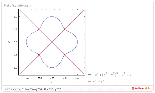

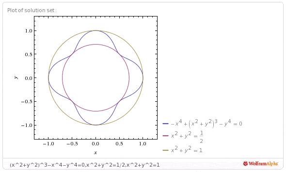

After messing around with a few sets of ordered pairs and a few other details, like graphing the region in the xy-plane, I like this transformation again.
Here's WolframAlpha's graph of the region in the xy-plane, along with the graphs of two circles, one with radius 1 the other with radius = 1/√(2) :
Here's WolframAlpha's graph of the region in the xy-plane, along with the graph of y = ±x .
Since x2 + y2 ≥ 0, u ≥ 0, for the region of interest.
The point (x,y)=(a, ±a) → (u,v)=(2a2, ±2a2), where the signs are correlated.
Specifically, the point (x,y)=(1/2, ±1/2) → (u,v)=(1/2, ±1/2) .​
The point (x,y)=(±a,0) → (u,v)=(a2,0) also the point (x,y)=(0, ±a) → (u,v)=(a2,0) .
Specifically, the points (x,y)=(±1,0) and (x,y)=(0, ±1) all go to (u,v)=(1,0)​
