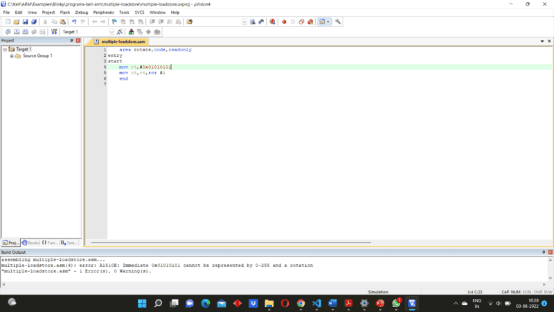

I am using immediate addressing to store a value in a register.
But I am getting an error: AI510E: Immediate 0x01010101 cant be represented by 0-255 and a rotation. My knowledge of ARM instruction lacks a bit.
MOV can store 32 bits as apparent from MOV r0,#0xFFFFFFFF
I don't know why is a number smaller than it is causing an error

The error message tells you exactly why this won't work:
Crystal037 said:
Immediate 0x01010101 can't be represented by 0-255 and a rotation.
There is no 32 bit MOV immediate instruction in ARM, there is an 8 bit MOV immediate followed by an even-number-of-bits rotation; there is also MVN which loads the complement. This leads to a restricted range of possible values explained in detail at https://developer.arm.com/documenta...nto-registers/Direct-loading-with-MOV-and-MVN

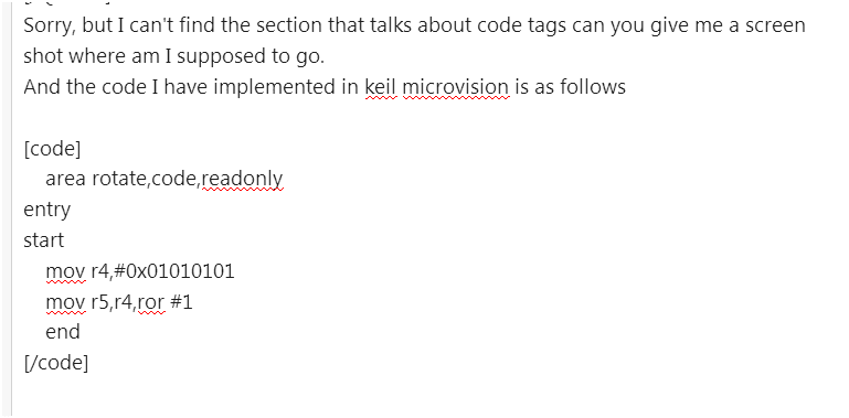

Sorry, but I can't find the section that talks about code tags can you give me a screen shot where am I supposed to go.
And the code I have implemented in keil microvision is as follows
Code:
    area rotate,code,readonly
entry
start
    mov r4,#0x01010101
    mov r5,r4,ror #1
    end
And the error I am getting is
multiple-loadstore.asm(4): error: A1510E: Immediate 0x01010101 cannot be represented by 0-255 and a rotation
About ARM having no 32-bit Mov instruction why am I not getting any error while using the constant 0xFFFFFFF1
Also can u explain me what do you mean by an even-number-of bits rotation.
Here you go:

Yes it does, this translates into a single 32 bit instruction containing the 16 bit immediate value. But if it is provided with a 32 bit immediate it will attempt to translate this into a single 32 bit instruction using an 8 bit immediate value and a 2k bit right rotation where k=0-15.
Because that is one of the permitted values (it is the bitwise complement of 0x0000000E).
