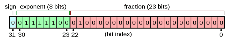

Consider the IEEE-754 format for Single Precision numbers. Provide your results in both IEEE-754 format (binary) and in decimal system.
a) Determine the smallest number ε such that 2 + ε > 2.
b) Determine the largest representable (positive or negative) number maxreal.
c) Determine the smallest representable (positive or negative) number minreal.
Hello! (Note : I put the prefix as comp sci, since at my uni this is a computer science class but I am in EE so it could be put under both prefixes. If anyone feels its more appropriate as Engineering feel free to change)
So here is my attempt at the solution
The formula that we are given is ## (-1)^s*M*2^E ## where M is the mantissa and E is the exponent and s Sign
Since its single precision the mantissa should be 23 bits The smallest number the mantissa can have is 1, (followed by 23 0's) . So the value that follows this, is the smallest value that can be addead to the mantissa, hence we can find our epsilon as follows
## \epsilon = \frac{1}{2^{23}} = 2^{-23} = 1,19 * 10^{-7} ## (roughly)
I think this part should be correct;
Now for the second part I tried it like this.
b) The biggest value the mantissa can have is M = 1,(followed by 23 1's) and the biggest value the exponent have is 127 hence ## 2^{127}##
So now I can plug in the formula ## (-1)^s * M * 2^E = 1,89*10^{38} ## where S is either 0 or 1 for positive or negative
Now the answer should be ##3,40*10^{38} ## and I really dont see how they get to that solution. The power of 38 is correct which confuses me, because that would implie that the formula I am using is correct no?
Thanks for the help!

real*4 2.0 is hexadecimal 40000000
2-23 = 1.1920929E-07 is hexadecimal 34000000
and 2+ 2-23 is hexadecimal 40000000 also.
arhzz said:
how do they calculate 3,40
##\mathtt {(2 − 2^{−23}) × 2^{127}≈ 3.4028235 × 10^{38}}##
There are 23 bits for the fraction The first (implicit leading bit) is always a 1 and is not stored. Effectively 24 bits
so the biggest possible fraction is FFFFFF (##\mathtt {(1 − 2^{-24})}## and ##\mathtt {2^ {(1 − 2^{-24})} = (2 − 2^{-23})}##.
wikipedia said:
The exponent field is an 8-bit unsigned integer from 0 to 255, in biased form: a value of 127 represents the actual exponent zero. Exponents range from −126 to +127 (thus 1 to 254 in the exponent field), because the biased exponent values 0 (all 0s) and 255 (all 1s) are reserved for special numbers (subnormal numbers, signed zeros, infinities, and NaNs).
so there is the ##\mathtt {2^ {127}}##
Fortran has a function HUGE that prints 7F7F FFFF hex

Okay now I see how they get the correct result, i retraced it step by s
Okay now I see it, I checked our slides again and the part about the implicit leading bit not being stored is what caused the confusion on my part. I was able to reproduce your answer and get the same result (I also have it in binary form as well)
Thank you for the help on part b)
But for part a) I realized that I made a mistake in my calculations. Reasoning is that we did a very similar example in class with ##1 + \epsilon > 1 ## and after looking at the solution it seemed to me that the "constant factors" (the 1 and in my example 2) did not impact the solution. Obviously this is wrong since it would mean for every number the solution would be ##2^{-23} ## and that just does not make sense.
So I am kind of stumped on how to do a) any insights?

I think I will try it like this;
What is the equation that relates the components of the normalized IEEE-754 single-precision representation to the value it represents:
$$ v \; = \; \left( -1 \right)^S \left( 1 \; + \; \frac{M}{2^{23}} \right) 2^{\left( E-127\right)} $$
Now I define ## v_1 = 2 ## and ## v_2 = 2+ \epsilon ##
Than we solve for ## \epsilon## and what comes out is my solution.
Does this make any sense for you?
@BvU you are confusing rounding epsilon with interval epsilon.
@arhzz given that 2 is twice the size of 1 it should be obvious that they could not both have the same value of epsilon.
BvU said:
I have shown that it is not the right answer (for my compiler). But probably the intended answer for a) is 2**(-23)
How are you getting that? If you're going to fit the numbers into 24 bits, you have
2 = 10.00 0000 0000 0000 0000 0000
2+e = 10.00 0000 0000 0000 0000 0001
Since there are 22 digits to the right of the binary point, the difference is 2^-22.
