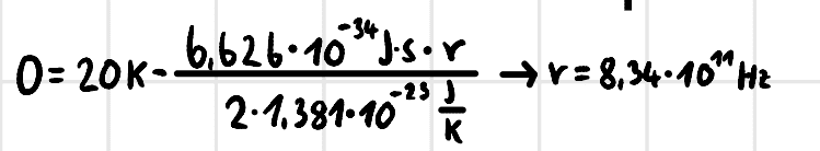

I am not quite sure if I have calculated the homework correctly :-)
I proceeded in such a way that I first calculated from which frequency the two terms are equal, and thus the equation results in zero.
Then I figured a relative accuracy of 10% equals a relative error of 90%. So I calculated at which frequency I have a relative error of 90% and exactly this frequency is the one I am looking for.
Am I thinking correctly, or am I completely wrong? :-)
I don’t understand the question.
I presume the Taylor series is for the exponential term in the Planck formula. Taking just the first two terms of that leads to the Rayleigh–Jeans approximation.
You quote an expression T-h*f/2*k. You don't say what that is a formula for, but setting it to zero does not sound promising.
But then, I do not see how knowing the intensity at a single frequency can be used to estimate a temperature. You would need two at least.

Thanks haruspex and Steve4Physics for your help. I asked my lecturer again, and he said that I only need this formula T - h*f/2*k to solve the problem. Unfortunately, he did not tell me more :-)

T - h*f/2*k is not a formula, there is no '=' sign. It is an expression and you haven't told us what it means or equals. (Note what @haruspex said in Post #2.)
Also, the expression could use some brackets to avoid ambiguity but I guess it is ##T - \frac {hf}{2k}##. so it is some sort of temperature or temperature-difference. But I don't recognise it.

Following @Steve4Physics' insight in post #3, we should take the first three terms of the expansion of the exponential in the denominator of Planck's formula. The first, 1, cancels with the -1 in the denominator. This leaves a factor ##\frac 1{\frac{h\nu}{kT}+\frac 12(\frac{h\nu}{kT})^2}=\frac{kT}{h\nu}(1+\frac 12\frac{h\nu}{kT})^{-1}\approx\frac{kT}{h\nu}-\frac 12##.
The Rayleigh–Jeans approximation is the same but without the ##-\frac 12##. So the question becomes, at what temperature does the R-J version diverge by 10%? If you juggle the equations you will find it is when the formula quoted in post #1 differs from T by 10%.
