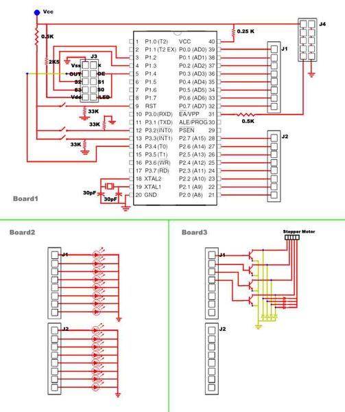

Greetings,
Currently, I'm designing a project to sort objects using AT89C52 as the "brain" and TCS230 as the "eye". And so, it is necessary for me to connect the AT89C52 with the TCS230 colour sensor and stepper motors. And before doing the real thing, i must know the frequency range of the sensor, i use leds to show me that.
I designed this circuit which I'm not so sure about.
The plan is to receive digital pulse from TCS230 colour sensor (J3), do something with the pulse with AT89C52, and send some output (J1 and J2).
The output will be connected to board 2 or board 3.
Board 2 is for displaying the RGB value from the sensor, while board 3 is for driving a 6V stepper motor.
I'm worrying about the voltages and the currents. I've added some resistors to the circuit, but I'm just not so sure about it.
Will the circuit work? Any suggestions?
Please forgive me if my english is not too good.
Thanks B4.

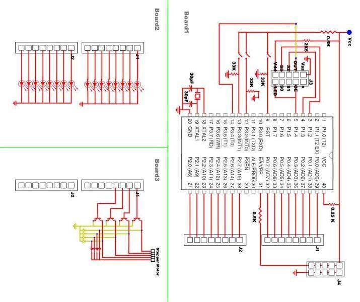

It's got to be hard to see.
i reviewed my post and i found out that it will make your head spin to see the image. so i repost the figure.
and since the picture is not so detailed, i want to note that the red arrowheads on board3 is meant to be diodes.

Try http://www.parallax.com/dl/docs/prod/datast/TCS230.pdf
They do discuss counting the color frequency.
The max frequency happens to be 600khz which is likely more than the AT89C52 can handle. They are thinking that you need to control the max illumination to fix this.

The truth is i already know how to handle the frequency, it is using the S0 and S1 pins on the sensor (and if that can not be done, we can always reduce the counting period:rolleyes: ). You can obtain the datasheets of TCS230 (i've downloaded em all) at http://taosinc.com. and about AT89C52 from www.atmel.com (this contains the DC characteristics)
It is the electrical design which worry me most. I will be using a regulated 5V 1A power supply as the Vcc. Will that be safe? The TCS230 costed me US$ 79. I don't want to waste that much money.
Ow yeah... i need to note here that I'm using the exact sensor on the link you shown above (TCS230). the TAOS real version is TCS230D with some electrical characteristics on the datasheets which i don't understand much.
Thanks anyway:biggrin:
Hmmm, I don't see a power requirement for the module.
Look on the TCS230D data sheet. Find Imax.
The rest of the components look like <50ma.
If your regulator is just a non heatsinked Ic its probably good for 300ma. If its a real spec 1A continuous power supply that's different.

I will use a transformator to convert voltage to 6V 1A, and i will use a L7805C-V to regulate power for the microcontroller and sensor (and that makes a Vcc for me). Is it safe to connect the output of the regulator directly to the microcontroller and sensor? I've added some resistors to limit currents (which I'm not so sure).
I've heard that when ICs overpowered, for example, given voltage higher than 5.5V, it will burned out.
Running Vss at 5.5v unlikely to damage an IC in a 5v logic family.
Having Vss at 5.0v and applying 5.5v to an input pin will likely destroy it.
I'd have to go back and look, but I think the documentation said that your sensor could be operated at 7v.
On you power supply design. 6v is low for a 5v regulator. You would need a very large capacitor.
A 5v regulator needs Vin min of about 7v over the entire AC cycle to operate correctly. A 10v transformer would be a better choice.
It's a trade off between how much heat you have to get rid of vs how big your input cap has to be.
Build your power supply.
Load it to double your expected load.
If it doesn't overheat and maintains regulation you will be ok. Regulator Ics are very reliable and rarely fail.
Don't forget the .1 bypass caps. They are important.
Putting a resistor in a power supply line is a very bad idea.
You could always add a crowbar regulator to kill any power supply failure.
They sell Ic to do this function :smile:
