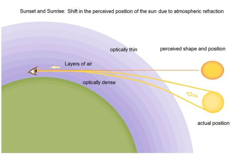

"Due to atmospheric refraction the position of Sun in the sky is different from its actual position."
But why doesn't Sun look like a rainbow in that case?
Different wavelength should follow different paths in atmosphere - no?
Why Venus does not look like a sequence of colours perpendicular to horizon?
Thanks.

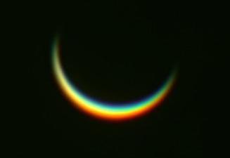

Is this an actual photo, or a drawing?
For some realistic Abbe number estimates, see
https://en.wikipedia.org/wiki/Abbe_number#/media/File:Abbe_number_calculation.svg

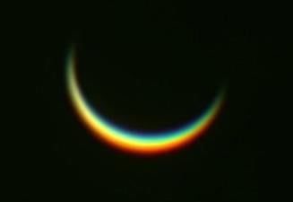

russ_watters said:
Reiterating and expanding on this: yes, the "rainbow effect" happens, but it is small, so you only notice it if you are looking at an object under high magnification:
[edit] That's Venus, not the moon.
That looks like chromatic aberration caused by the optics, not the atmosphere.
It's a 'picture' of a recognisable effect. I think we all recognise the amount of angular separation in glass, whichever.

Maybe they are similar, but this is a real/known thing in astrophotography. Most astro image stacking/editing software has feature for "RGB Align" and there's even an adjustable prism for fixing it in the optics:
https://www.skyatnightmagazine.com/astrophotography/atmospheric-dispersion-corrector
I've not heard of ADCs, thanks. Have/do you use one? It seems like those devices (at least the ones I saw) require constant adjustment as the night goes on and the altitude changes....?
I bought one a few months ago, used it once so far. They only matter when the planet is relatively low and magnification high. Right now Jupiter and Mars are high, so I don't need it. I'm going to try Venus in the next month or so, so I'll use it then.
I had always thought that doing an rgb align in software would fix the issue but apparently you get a lot better results for lower in the sky objects with it.
