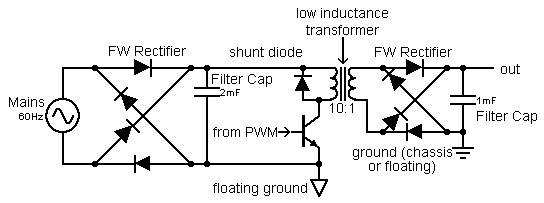

After some study with simulations, I've been trying to find a way to increase transformer current by increasing the operating frequency and decreasing it's size, mass, cost, and turns. It seems to make sense that I can make a much cheaper and higher current transformer by doing the following, and I would like some guidance to see if I'm on the right track:
  • Use a higher operating frequency- 50-100kHz or so?
  • Use a higher frequency core type- ferrite or powdered iron?
  • Use relatively fewer turns of low gauge wire to support higher current, and thus lower inductance so it's able to operate a high frequencies.
  • Use a simple transistor with an oscillator to switch the primary on and off
  • Possibly be able to modulate the oscillator depending on the load of the secondary, perhaps to the point of shutting off it there is no demand.
My goal is to:
  • Reduce weight, volume, cost, etc.,
  • provide much higher current in a smaller package, and
  • be able to select a precise voltage by winding it myself.
It seems to me that if this was practical and cost effective, it would already have been done, but it's worth a try. My draft schematic is attached.
Schematic of a PWM-switched transformer power supply: mains input feeds a full-wave rectifier and 2mF filter cap, a transistor driven from PWM switches the primary of a low inductance 10:1 transformer, and a second full-wave rectifier with 1mF filter cap feeds the output.
hi there
welcome to the forums
been done years ago (at least 40yrs) :) its an old idea that is used in EVERY switch mode power supply that you see today.
they are from small plug packs to very large H.Volt / Hi Current systems
Google SMPS
cheers
