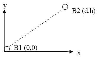

Ball 1 (B1) and Ball 2 (B2) are located at (x,y)=(0,0) and (x,y)=(d,h).
At t=0, B1 is sent towards the initial location of B2 with a speed vi. At the same
instant that B1 is launched, B2 falls towards the ground with zero initial velocity.
Assume there is no air resistance.
picture attached
1. When and where do B1 and B2 collide?
none can't start...
You will want to figure out the when part before the where part. When does B2 hit the ground? What is the condition for B1 to hit B2 then?
im pretty sure the question is asking when will they hit in the air not after b2 lands
- There is no ground level given (the natural assumption that h=0 was ground level is arbitrary). Don't worry about that for now, you can rethink the case h<0 later.
- The condition for the two balls to meet is having the same position at the same time (for arbitrarily small balls, at least).
