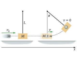

The Question
In a ballistic pendulum an object of mass m is fired with an initial speed v_0 at a pendulum bob. The bob has a mass M, which is suspended by a rod of length L and negligible mass. After the collision, the pendulum and object stick together and swing to a maximum angular displacement (theta) as shown
An experiment is done to compare the initial speed of bullets fired from different handguns: a 9 mm and a .44 caliber. The guns are fired into a 10-kg pendulum bob of length L. Assume that the 9-mm bullet has a mass of 6 g and the .44-caliber bullet has a mass of 12 g . If the 9-mm bullet causes the pendulum to swing to a maximum angular displacement of 4.3degrees and the .44-caliber bullet causes a displacement of 10.1degrees , find the ratio of the initial speed of the 9-mm bullet to the speed of the .44-caliber bullet, (v_0)_9/(v_0)_44.
My Solution
I already found the inital speed of the fired object: v = ((m+M)/m)*sqrt(2gL[1 - cos(theta)]). So I am given m (bullet mass), M (block's mass), g (gravity), and theta. I plugged those into the equation and got (v_0)_44=((10kg + .012)/10kg)*sqrt(2*9.8*L[1 - cos 10.1]) and (v_0)_9=((10kg + .006)/10kg)*sqrt(2*9.8*L[1 - cos 4.3]).
Am I on the right track? What happens after?
You have the masses subtracted not added in the equation... Supposed to be added...
Once you solve for each velocity... Then you do the ratio of one to the other like you had above.
Oh, my mistake. That's a typo right there. I editted it already. Let me try to solve it.
I got .443 for the 9mm and .633 for the .44-caliber. Is this right? The numbers look weird.

I've got these two equations:
(v_0)_9=((10 + .006)/10)*sqrt(2*9.8*L[1 - cos 4.3])
(v_0)_44=((10 + .012)/10)*sqrt(2*9.8*L[1 - cos 10.1])
I'm solving for velocity. When I find (v_0)_9 and (v_0)_44, I can just divide them to get the answer. I got .70. Is it a calculation error? Or is there something wrong with my equations?

I also get 0.70 using the same equations... which does sound right...
I think the velocities you are getting are correct just off by a factor by a thousand... I am thinking the mass has to be converted to grams... which gets you velocities that make more sense.
How will it change the result? Because (10000+6)/10000 and (10000+12)/10000 is still the same as when it was in kg.
Just looking at this quickly, but shouldn't the entire expression for the velocity be included in the square root? So it would be v = sqrt ((m+M)/m)(2gL[1 - cos(theta)]).
No, I'm pretty sure v = ((m+M)/m)*sqrt(2gL[1 - cos(theta)]) is correct.
You're right on your equation, however when you put the numbers in you're dividing m+M by M, when you should be using m the mass of the ball. so it's
(10+.006)/.006,
not
(10+.006)/10
