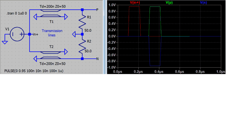

Here is a simple transmission line phase-splitter that generates 0° and 180° phase signals. In effect coupled lines are being operated to extract odd and even modes. You can use twisted pairs for the transmission lines at high frequencies, or wind those pairs onto a toroid to make transmission line transformers for use at longer wavelengths.

Ahh. I don't have mine with me right now, but if I'm understanding you correctly, you're saying this device can just be used to shift the phase 180 degrees when terminating the other output?
I'm a little confused by the spice model. I thought I should still lose 3dB of signal relative to the input when using a hybrid coupler. I believe stated you are modeling a transmission line phase-splitter, so is this a bit different than hybrid coupler where I would use either the diff or sum port? In this spice model I see Vp and Vn having the same amplitude as Vin, I'm trying to wrap my head around that.
Also, when speaking about even and odd modes - does this mean 0 degrees is the even and 180 degrees is the odd?

Yes. The signals inside the transmission line are independent of the outside. Who is to say what and where is the output reference ground.
I produced a quick ideal model with a zero impedance voltage source. A more realistic model would need series matching resistors where the two lines are driven in parallel. Including matching networks will give you the amplitude reduction expected. Also, the ideal numerical output impedance matching prevents all reflections and so the model could get away without series termination at the input.
In a twisted pair, each conductor will couple to the other, but they will also both couple indirectly via the screen or environment. Since magnetic coupling can be seen to reverse the direction of the coupled wave, the count of coupling events in the coupling path will decide the mode as being odd or even, with implications to forward or backward, summing or subtracting, inverting or non-inverting.
