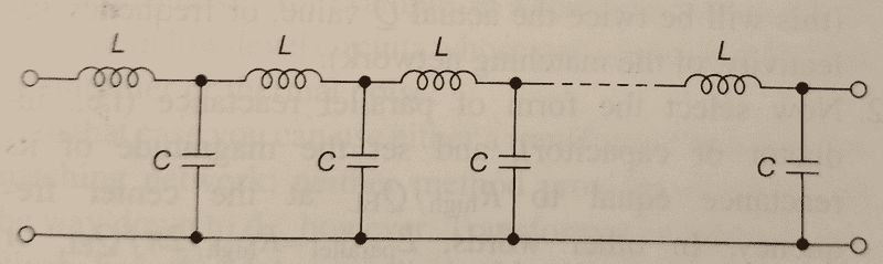

You mean something like this?
Yes, exactly.
It requires a more complex network, not simply two inductors in series.

A chain with inductors and capacitors constitutes a delay line which can introduce any phase shift you require with enough stages.
