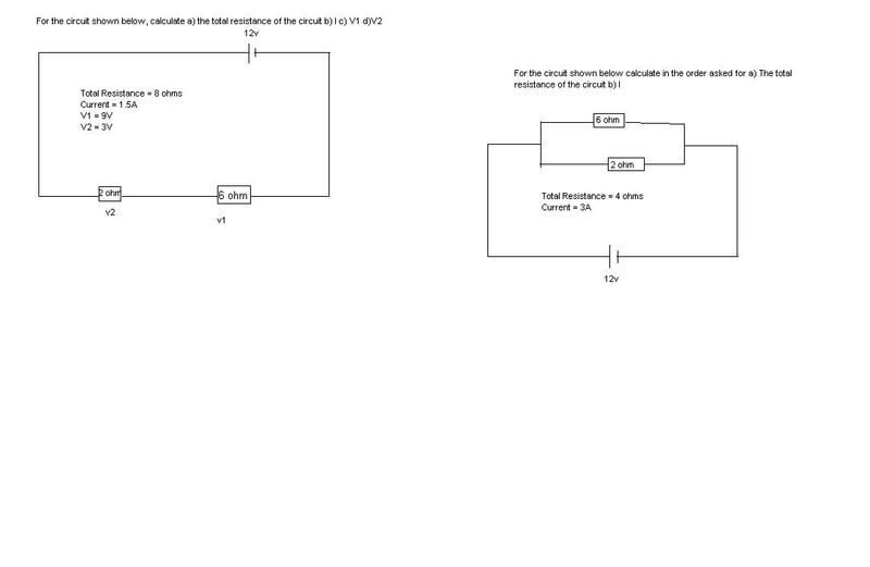

Can someone please check my answers here, there are loads of formulaes been give that I haven't used so I'm not sure if they are right or not, thanks.

The first problem (resistors in series) is done correctly, but the second (resistors in parallel) is not. Recalculate the total resistance in that second circuit. Hint: When resistors are in parallel, the total resistance will be less than that of any single resistor.
The total resistance of resistors in parallel can be calculated with
[tex]\frac{1}{R_p} = \frac{1}{R_1} + \frac{1}{R_2}[/tex]
this can be changed to
[tex]R_p=\frac{R_1R_2}{R_1 + R_2}[/tex]
When I do that I get 6x2 = 12ohm 12ohm/8 ohms = 1.5 ohms, is that right?
Yes. That seems to be it.

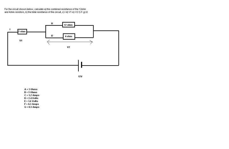

Ok I think I'm not sure If I've got this right. I worked out I1 and I2 using fractions.

Rethink your answer for C (the total current).
The current through the 2 ohm resistor is the current through all of the circuit since
[tex]I = I_1 + I_2[/tex]
So [tex]I[/tex] will be be determined by the total resistance of the circuit and the voltage of the power supply.
Ok we went through that question today and I got A-F right but G was 0.9A.
12/5 does not equal 1.2, maybe you sent us the wrong version of the problem, or the teacher did it wrong
Ah sorry I put 12v instead of 6, doh.
