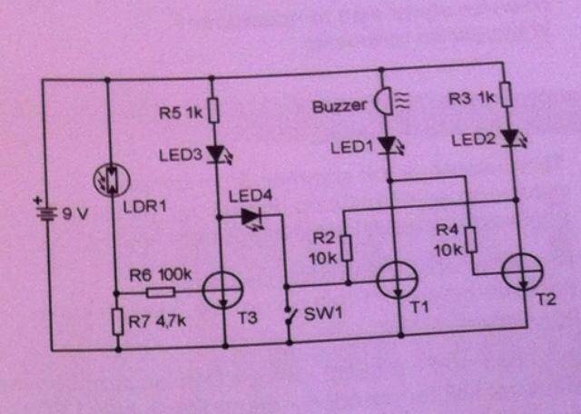

1. Homework Statement
How does this circuit function? Where do the electricty flow?
No equations
Not sure what to put here?
My question is basically how it work. As far as I know, the circuit starts at the positive side of the power source, and "splits" by some part of the electrons going to the LDR1 and the other part continues going to the right, and continues branching everytime it can. But how does the light sensitivity thing work? Where do the electricity go for it to start the siren/buzzer? There is nothing near LDR1, so what activates it and what makes it stop, if there is no resistor or anything there to stop it?

Well, without going through and analyzing it, I'm not really sure, it's a fairly complex circuit. Start at the battery, and trace every path. Write the sum of the voltage equations, make sure you keep track of the parallel and series components appropriately, and if you get stuck then maybe I can help more.
As it's homework we aren't meant to give you the answer, just hints so you can solve it yourself.
I would start at the siren/buzzer. What has to happen for the siren/buzzer to sound?

It has to be dark. When it gets darker the siren will sound.
Can I ask another question then? It is not part of the homework but is related to this.
In class when we built this circuit. We also measured Ohms to it. I found out that the darker it is the higher the resistance is. less light = high resistance. But how does this happen?
The sensors could possibly break down under light, making it easier for the current to flow.

What I meant was..
For the buzzer to sound electricity has to be flowing through it so T1 must be ON.
For T1 to be ON...
Edit: It might be easier to start with the assumption that the buzzer is OFF. That implies T1 is OFF. What about T2... Go around the circuit marking it up with approximate voltages or logic levels.
LDR1 is a Light dependent Resistor aka Photoresistor..
http://en.wikipedia.org/wiki/Photoresistor
