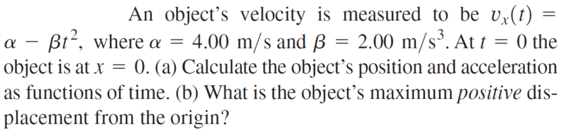

Printed problem text: velocity v_x(t) = α − βt², with α = 4.00 m/s and β = 2.00 m/s³; at t = 0 the object is at x = 0. Asks for position and acceleration as functions of time, and maximum positive displacement.
a=dv/dt, v=dx/dt, x=integ(vdt)

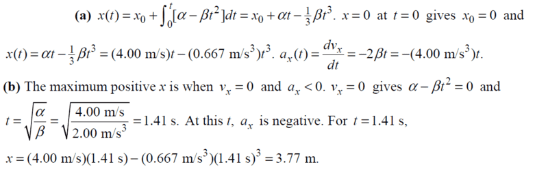

Worked solution to a kinematics problem: x(t) = x0 + integral of (alpha - beta t^2) dt gives x(t) = alpha t - (1/3) beta t^3, with x(0)=0; part (b) finds t = sqrt(alpha/beta) = 1.41 s and maximum x = 3.77 m.
We were given the above problem and solution. Everything seems very straightforward. My question is this: should the function for acceleration also include a constant, e.g.

  • Printed problem text: velocity v_x(t) = α − βt², with α = 4.00 m/s and β = 2.00 m/s³; at t = 0 the object is at x = 0. Asks for position and acceleration as functions of time, and maximum positive displacement.

  • Worked solution to a kinematics problem: x(t) = x0 + integral of (alpha - beta t^2) dt gives x(t) = alpha t - (1/3) beta t^3, with x(0)=0; part (b) finds t = sqrt(alpha/beta) = 1.41 s and maximum x = 3.77 m.

Taulant Sholla said:
None of the given initial conditions seem to indicate that a(0)=0.
On the contrary: it is easy to see that ##a(0) = {d\over dt} (\alpha - \beta t^2) \Bigr |_{t=0} = 0##
It is not wise to use the same symbol ##\alpha## for two different things :rolleyes:
A constant only appears if you are given e.g. a velocity and need to calculate the position.
If you have the position as a function of time, the velocity is unambiguous: no constant.
Mutatis mutandis for acceleration and velocity.
When you find the acceleration you take the derivative of the velocity function. Only when you integrate a function do you have to add a constant.
