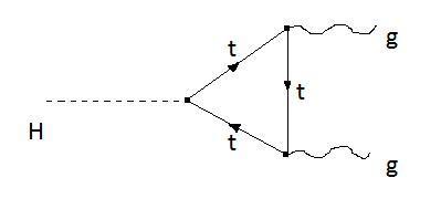

If I understood well, with a process , let's say: H -> gg.
We treat H like a scalar field boson so we with the Feynman Rules in front, draw the possible diagrams at tree level, which should be "easy". And then... well, for one-loop level could be many ones so how to know which contribute more? This is a more generic and basic question. Because I can draw loops here and there. I suppose that in our case we just have to draw one diagram with a loop on the gluon external line, another diagram on the other gluon external line, other diagram with a loop on the H incoming line and a last diagram with a loop on the vertex?
One Loop-order?
But how could I computed a virtual top quark loop is produced, and not any other quark?
There could be more (eg bottoms), but the Higgs dominantly couples to top quarks (they are the heaviest or should I say they have the largest Yukawa coupling).
Also I don't think there is any lower order for this transition... there is no tree coupling between Higgs and gluons since the Higgs is an SU(3) singlet (color-chargeless).

The last is a common knowledge, I mean there can only be effective couplings between the higgs and gluons... or you can't write in your lagrangian a term such as [itex]h GG[/itex] without breaking your SM symmetry ([itex]h[/itex] is a doublet of SU(2) )... this terms appears effectively via the triangle diagram.
The first thing, is just by looking at the Yukawa couplings? (couplings of your fermions[quarks] to scalar fields[higgs this time] )

If I have for example H > gg, I look to the posible vertex which have gluons, those are quarks, ghosts or more gluons. Then I check to H possible vertex and there is one with 2 fermions so the only possible way is to make a triangle of 3 quarks in between as the diagram you posted.
I do not like this way of work. That is why I am asking here how to compute these kind of things more "seriously".

There is no general way to look at diagrams and say "this is more important". There are many cases where it is possible, but sometimes you just have to calculate it with QFT (which takes a lot of time).
"Higgs couples to mass" is one of those rules that help in many diagrams - every quark, every charged lepton and the W boson can run in this loop for the diphoton decay, but top and W are by far the heaviest particles in this group so their contribution will be dominant.
This sounds tiring... but in general it's a way... I don't know whether (unconsciously) I am doing this process when I try to think of a diagram...
I would just remember from the Lagrangian that the scalars couple to fermions (so the Higgs->fermion+fermion would be the thing that would come in my mind). Then I would think that you need two external gluons, and so what else could it be but the fermions to be quarks (no other fermions couple to gluons)... then I already think you have been told enough about which quark would be the most dominant one. It's all in the Lagrangian. So I guess I am moving with the symmetries. I wouldn't follow your way, which gives me the impression that you follow the algorithm:

lepton possibilities? if you have more than one possible leptons in a process, in general you have to take it into account. For example I wouldn't even have to write the [itex]t[/itex] quark in the triangle propagator I posted before. There are all fermions going around. Of course (as I mentioned) the dominant one was the top... if you don't know what is the dominant, you have to write all of them, because all these diagrams would in general contribute...
That is something happening quite often when you get quark loops... each loop of these quarks is appearing with a multiplicity of 3 (because of the colors). So you could write three diagrams with the same quarks but with different colors, or you could write 3 times the one diagram (exploiting the color symmetry).
