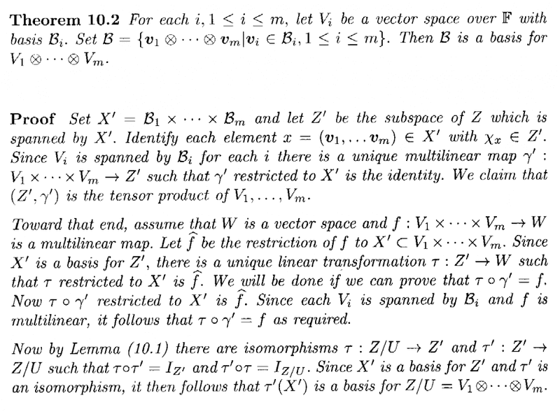

I am reading Bruce N. Coopersteins book: Advanced Linear Algebra (Second Edition) ... ...
I am focused on Section 10.1 Introduction to Tensor Products ... ...
I need help with an aspect of Theorem 10.2 regarding the basis of a tensor product ... ...Theorem 10.2 reads as follows:
I do not follow the proof of this Theorem as it appears to me that [itex]Z'[/itex], the space spanned by [itex]X'[/itex] is actually equal to [itex]Z[/itex] ... but the Theorem implies it is a proper subset ... otherwise why mention [itex]Z'[/itex] at all ...I will explain my confusion by taking a simple example involving two vector spaces [itex]V[/itex] and [itex]W[/itex] where [itex]V[/itex] has basis [itex]B_1 = \{ v_1, v_2, v_3 \}[/itex] and [itex]W[/itex] has basis [itex]B_2 = \{ w_1, w_2 \}[/itex] ... ...So ... following the proof we set [itex]B = \{ v \otimes w \ | \ v \in B_1, w \in B_2 \}[/itex] ... ...Elements of [itex]B[/itex] then are ... ... [itex]v_1 \otimes w_1, \ v_1 \otimes w_2, \ v_2 \otimes w_1, \ v_2 \otimes w_2, \ v_3 \otimes w_1, \ v_3 \otimes w_2[/itex] ... ...and we have[itex]X' = B_1 \times B_2[/itex]
[itex]= \{ (v_1, w_1) , \ (v_1, w_2) , \ (v_2, w_1) , \ (v_2, w_2) , \ (v_3, w_1) , \ (v_3, w_2) \}[/itex]Now [itex]Z'[/itex] is the subspace of [itex]Z[/itex] spanned by [itex]X'[/itex] ... ...But [itex]B_1[/itex] spans [itex]V[/itex] and [itex]B_2[/itex] spans [itex]W[/itex] ... ... so surely [itex]B_1 \times B_2[/itex] spans [itex]V \times W[/itex] ... ...
... BUT ... this does not seem to be what the Theorem implies (although it is possible under the proof ...)
Can someone please clarify the above for me and critique my example ... how is [itex]Z'[/itex] a proper subset of [itex]Z[/itex] ...?Hope someone can help ...
You didn't say what ##Z## is. See my post about 30 mins ago in your other thread for the formal definition of what I think Cooperstein means it to be. Then ##Z## is not the same as ##V\times W##, so if ##\mathscr{B}_1\times\mathscr{B}_2## did span ##V\times W##, that would not imply anything about spanning ##Z##. But in fact ##V\times W## is not even a vector space, so we cannot meaningfully talk about any set spanning it.
The simplest way to see this is that, in your example, ##\langle 2v_1,0\rangle## and ##2\langle v_1,0\rangle## are different elements of ##Z## because ##\langle 2v_1,0\rangle## and ##\langle v_1,0\rangle## are separate elements of the (uncountably infinite) basis.
EDIT: the above para makes an identification without stating it, that may be misleading. See post 6 below for a correction.
It feels very natural to believe that we can take the 2 outside the angle brackets because, after all, we're dealing with vectors, and can't you always do that with vectors because, you know, linearity? But if we look for a rule that allows us to take the 2 outside the brackets in that case, we don't find one. So inside it has to stay, and the two items remain different.
Also, note that ##Z## is infinite-dimensional, so it cannot be spanned by a finite collection of vectors, which is what the image of ##\mathscr{B}_1\times\mathscr{B}_2## is.
It is only when the quotient is taken, over the subspace of ##Z## generated by all formal sums that we would 'like' to be zero, that we obtain a finite-dimensional space again.

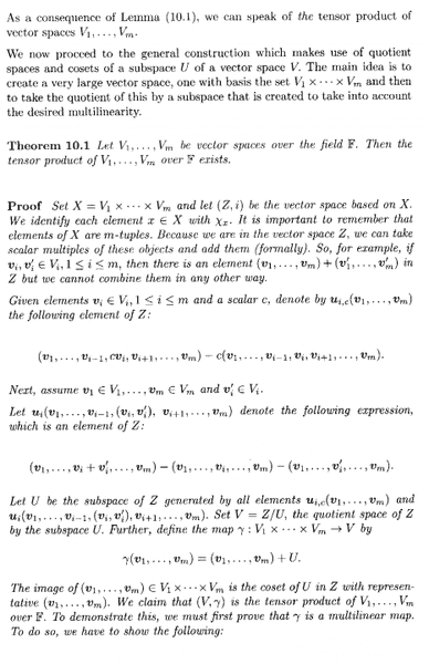

... sorry I did not present a definition of Z ...
Z is defined in Cooperstein's introduction to Section 10.1 and is used in Theorem 10.1 ... so I am providing relevant text now ...
Hope that helps to give a good idea of the definition and characteristics of Z ...

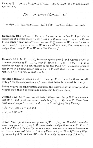

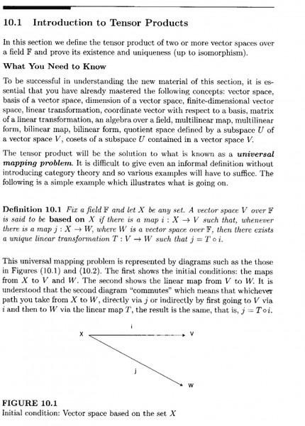

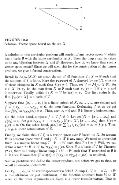

##V\times W## is the set of all ordered pairs of the form ##\langle v,w\rangle##. If the field ##F## is infinite then so will ##V## and ##W## be, and hence ##V\times W## will also have infinite cardinality.
Now ##V\times W## is the base set for the vector space ##Z##, which means that there is a bijection between elements ##\langle v,w\rangle## of ##V\times W## and elements ##\chi_{\langle v,w\rangle}## of ##Z##. Hence, since ##V\times W## has infinite cardinality, so does the corresponding basis of ##Z##. So ##Z## is infinite-dimensional.
##Z## is the set of all maps from ##V\times W## to ##F## with finite support. Consider such a map ##K## that is nonzero only on ##x_1,...,x_g\in V\times W## and gives values ##a_1,...,a_g## at those points. Then we have
$$K=\sum_{k=1}^g a_k\chi_{x_k}$$
This expresses the vector ##K## as a finite sum of basis elements of ##Z##.
The sum we are using here has the following meaning. Where ##f,f_1,f_2:S\to F## are maps from a set ##S##to a field ##F## and ##a\in F##:
(i) the map ##af:S\to F## is defined to be the map that takes ##s\in S## to ##af(s)\in F##; and
(ii) the map ##(f_1+f_2):S\to F## is defined to be the map that takes ##s\in S## to ##f_1(s)+f_2(s)\in F##

Math Amateur said:
now ##(2v, w)## is different from ##(v, w)## and so we get two basis vectors of ##Z## from these two elements of ##V \times W## ... ... but I do not see how ##u + v## becomes a basis element (I am taking this to be what you are saying) ... ... it does not belong to V \times W ... ...
Can you clarify/explain ... ...
What I had intended to convey (but did not do so as precisely as could have been) was that if ##u,v\in V## and ##w\in W## then ##(u+v,w), (u,w)## and ##(v,w)## are all distinct elements of ##V\times W## and hence they correspond to three different basis vectors of ##Z##, which are ##\chi_{(u+v,w)},\chi_{(v,w)}## and ##\chi_{(v,w)}##. In particular, we have
$$\chi_{(u+v,w)}\neq \chi_{(v,w)}+\chi_{(v,w)}$$
just as we have
$$\chi_{(\lambda v,w)}\neq \lambda\ \chi_{(v,w)}$$
in the scalar multiplication case (here ##\lambda\in F##).
