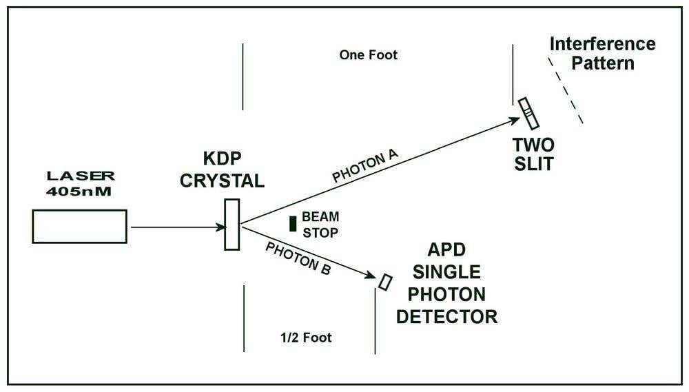

I am just starting to learn quantum mechanics. And have some questions on entanglement. I have learned that when there is two particles entangled that they share the same wave function and cannot be considered by themselves. I am having a hard time understanding some of the nuances of this concept. I have attached a diagram of the setup I have imagined. The setup uses a laser of 405nm to send photons thru a KDP crystal. This will produce two 810nm entangled photons, both having same polarity. This is then sent down two different paths, one photon (photon a) toward a 2 slit plate and the other (photon b), at half the distance, to a photon detector.
What will happen if you send one photon at a time through this setup in one of two different modes. In the first mode the APD detector is not used (taken out), and the second mode the APD detector is used. In the 1st mode, I imagine the 2 slit photons (photons a) will make a diffraction pattern. My question is in the 2nd mode, the one with the detector in place, will the photons going thru the 2 slit plate and sill interfere with each other? I am assuming that the collapse of photon B's wave function would collapse the photon A's wave function too. Or is this a wrong assumption?

Why would detecting a photon at B or not affect the interference pattern at A?
Are you assuming that if a photon is detected at B, then the photon at A collapses from a wave to a particle? If so, you have not understood the basics of QM. There is no wave-particle duality in QM.
The interference is not caused by photons interfering with one another, but instead each photon interferes with itself.
The easiest way to understand the double slit experiment is to consider that the probability of the photon being detected at any point on the screen is calculated by adding the contributions (some positive, some negative) to the probability amplitude from every possible path from source to screen. In your setup, paths through both slits are possible, and they add in such a way that we get alternating regions of high and low probability on the screen - an interference pattern. Nothing we do to photon B changes the paths available to A.

A couple of things that you might not be aware of.
a. The distance on the diagram is marked as 1 foot for one apparatus, 1/2 foot for the other. The distance is not a factor in any observable (or otherwise known) fashion. In other words: the order of measurement makes no difference. You could reverse the distances, and nothing would appear different.
b. The double slit side (as drawn) always produces a double bar pattern characteristic of "no interference". While the explanation of this is somewhat complicated, there is a way to produce the characteristic interference pattern. That is: you place a single slit before the double slit. That ends the entanglement (for that particle) but leads to the coherence needed for the interference to appear.

Ahh, the latter is what I thought. The book I had talked about the entangled photon shared a wave function and that they could not be considered apart. I assumed that would mean that what happened to one could and would affect the other. Also I thought that the photon moved as a wave but is detected as a particle?
Thanks for the reply, that helps

Ok thanks, I was thinking (or wrongly thinking) that when the photon B is detected that it would prevent photon a from interfering with itself.
